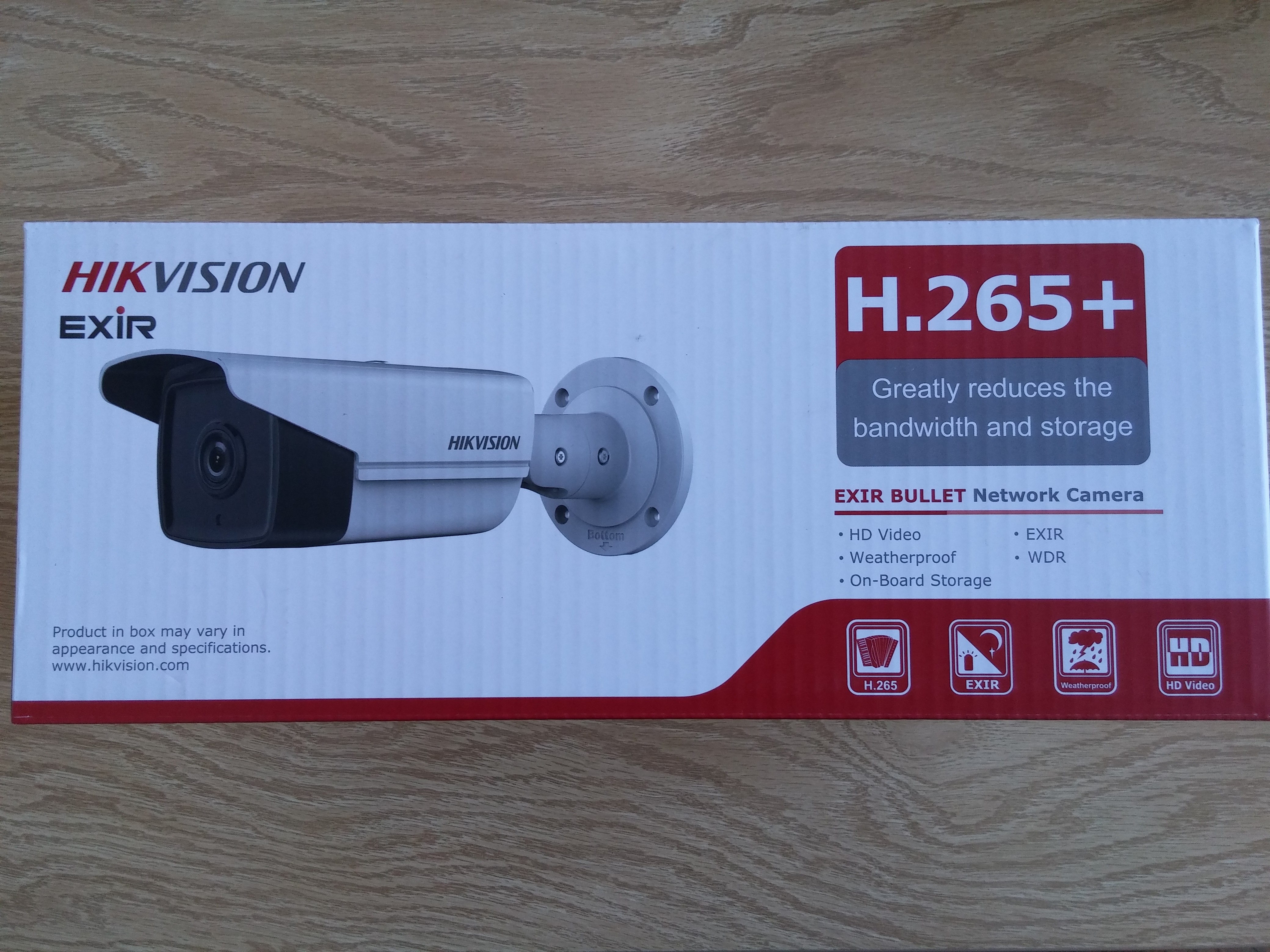

Thanks for your help!! But where do you see that the 2T23 is also EXIR? I dont see that feature in the specs on the Hikvision website for that model.
It is my assumption due to the construction, and because I recall that when they first introduced EasyIP3.0 they forgot to mention EXIR on the datasheets, even though it was clearly stated on the product boxes.
Prior to EXIR their technology was the traditional ring of LEDs around the lens.
You'll see that on predecessor models such as the 2632 and 2032.
I cannot find any statement to back up my assumption.
There is very little info on the EasyIP 2.0Plus models.
Ok I see. The cams have definitely not a ring of IR Leds, they have 2 LEDS, one on the left and one on the right of the Lens. Dont know if thats an indication for EXIR.
Here is a latest model EasyIP 3.0 Series 2T35 model similar to yours:
Product page here - Hikvision DS-2CD2T35FWD-I5 3MP Bullet Network Camera
Datasheet here - https://www.use-ip.co.uk/datasheets/5536/hikvision_ds2cd2t35fwdi5_3mp_bullet_network_camera.pdf
Photo of the product box clearly showing it is EXIR:
