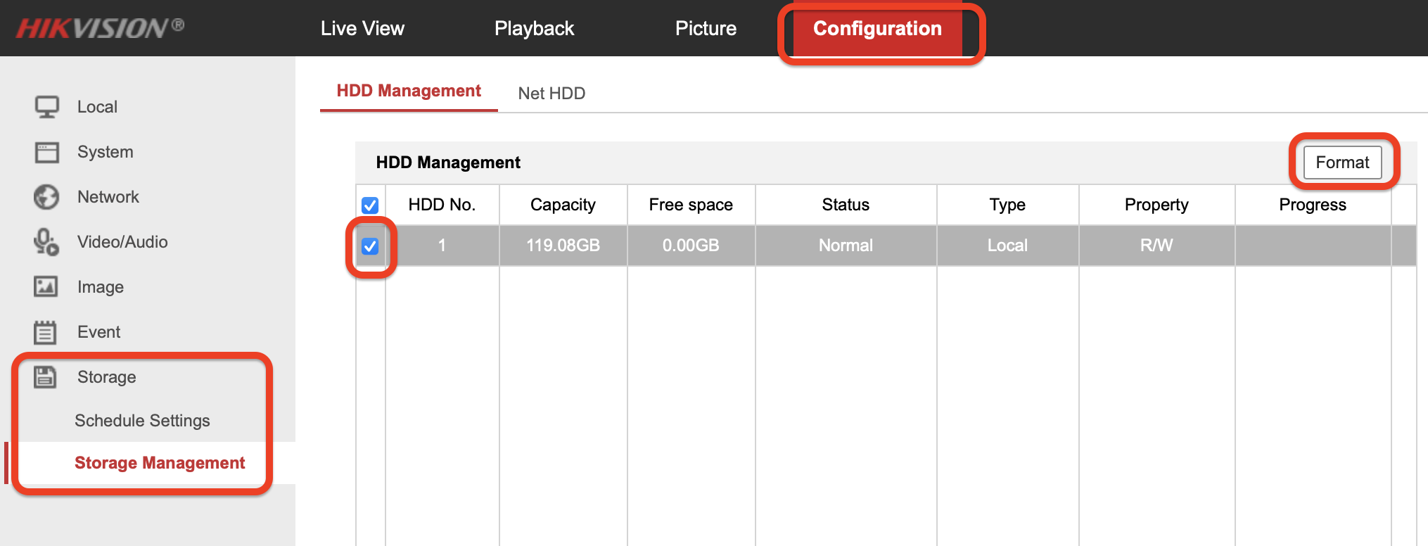

better to put the sd card into the camera and format it from the web interface. menu Configuration> Storage> Storage management. select the drive and click format.
