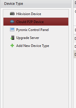

Hi Phil,
Port forwarding is all set up and is working i can access the cameras on a browser form the other sites, just want to use the ivms 4200 client to view them on the desktop.
I was testing 'clould p2p device' way of connecting to the ivms 4200 software using the same login for hik-connect.com, but the cameras come up with error 'opensdk(2028).
What would be the best way too add cameras/NVR to the ivms 4200 client?
