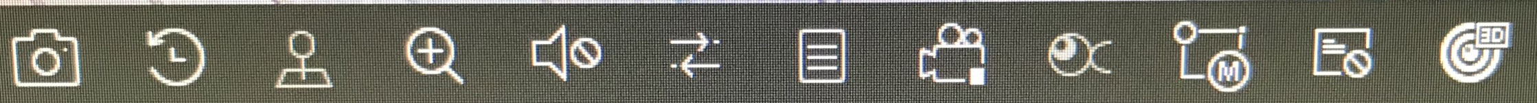

Please see the image attached with what I am able to see on the live stream. I don't appear to have that option. I have the DS-7608NI-I2/8P. It is on firmware v 4.51.025, build 210927 if that helps.
Hope you understand what I mean, so at the moment the notifications are fine but one or two show nothing. So just to double check I'm wondering if I can get it to draw a box around the trigger point. I have checked when I do for example vehicle search... when I click on the thumbnail it puts a green rectangle around it.
I'm just wondering if its possible to do that for the alerts too. For example, like can i view the alerts log on the NVR itself and double click a thumbnail and see if it identifies the trigger point of said alert?

Hi @Ultra4
You are a couple of firmware versions behind, see the latest versions HERE
We would recommend that you update to v4.60.000 and then update to the latest v4.61.000 as there are some bigger changes in these updates that might not work properly if you jump too many versions in one go.
I think we may not be talking about exactly the same thing, I wasn't aware that logged events show where the event triggered. Some smart events do not show the green boxes around event activity so it may just be that the particular event you are using does not support that feature.
