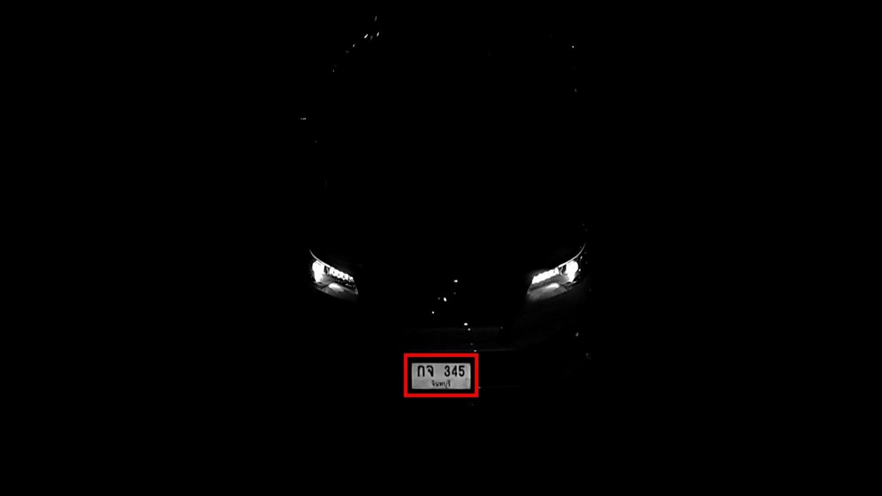

Your shutter speed is still too slow , if you are able to see anything else besides plate and lights.
Keep pushing shutter until result is PLATE + LIGHTS everything else is pitch black
Upvote 0
Something like this
Upvote 0
