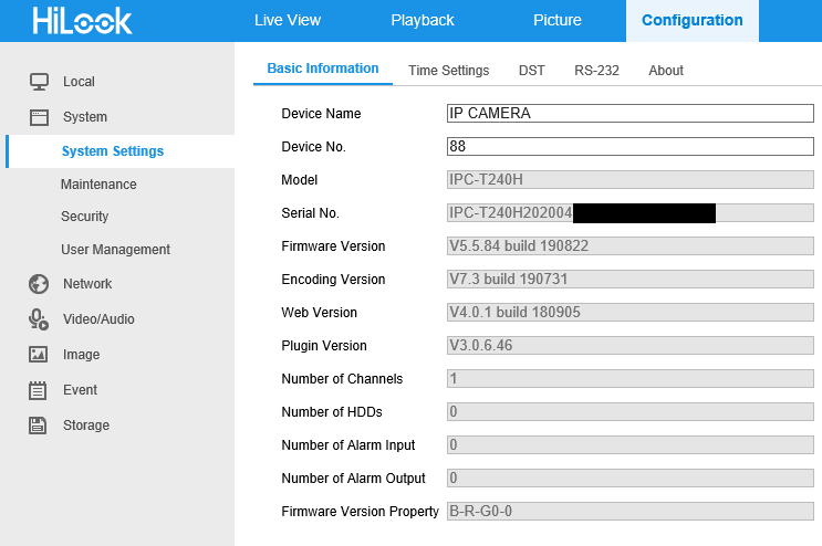

Hi All. I'm going on my 3rd day looking for firmware for a HiLook IPC-T240H.
Current firmware is:
FW: V5.5.84 build 190822
ENC: V7.3 build 190731
WEB: V4.0.1 build 180905

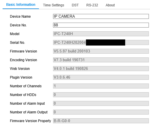

Hi @HikvisionSucks
When you log in to the camera and go to the Configuration > System > System Settings > Basic Information can you confirm the "Firmware Version Property"?
This information is usually displayed on Hikvision cameras so I would assume that HiLook as their consumer brand would also display this information, but we have never sold or worked with HiLook so our knowledge is limited.
Thanks @HikvisionSucks
So it would appear to use a G0 firmware and looking at the release notes for the latest HiLook G0 firmware - v5.5.87 - it does appear to support the T240H model.

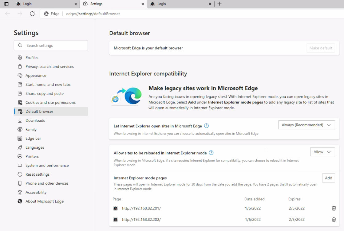

For anyone reading. Firefox, Chrome and Edge still not supported FFS. Probably the last update they will ever do for the camera and they didn't bother removing the browser useragent check for login.
Again, for anyone reading from the future trying to find a solution for this camera, after much stuffing around i found this works for basic settings:
Firefox: 95.0.2 64-bit
Addon: User-Agent Switcher and Manager – Get this Extension for Firefox (en-US)
Set UserAgent to be "IE 10 For Windows 10"
UserAgent willbe: "Mozilla/5.0 (compatible; MSIE 10.0; Windows NT 10.0; WOW64; Trident/7.0; Sleipnir6/6.4.4; SleipnirSiteUpdates/6.4.4)"
AppVersion will be: 5.0 (compatible; MSIE 10.0; Windows NT 10.0; WOW64; Trident/7.0; Sleipnir6/6.4.4; SleipnirSiteUpdates/6.4.4)
And you can log into the damned device with a modern browser. What an insane thing to have to ask clients/customers to do.

All Hikvision firmware is quite confusing, but the HiLook range takes it to another level. One of the first things to check is the Firmware Version Property which for your camera is B-R-G0-0 (see above)
The G0 in that code is the firmware family that your camera uses and this should guide you pretty much to the correct version in the download portal, the portals are the other thing to be aware of when looking for firmware. There are 2 main portals - UK & EU - and you can switch between these by clicking the link at the top of the download portal, if you can't find your firmware in one portal you should check the other and if you can find it in one it is also worth checking the other because sometimes one portal will list a slightly new firmware than the other. There is little to no difference between the UK & EU firmware so if you have a model you purchased in the UK and the latest version is listed on the EU portal there shouldn't be any issues using that firmware.
