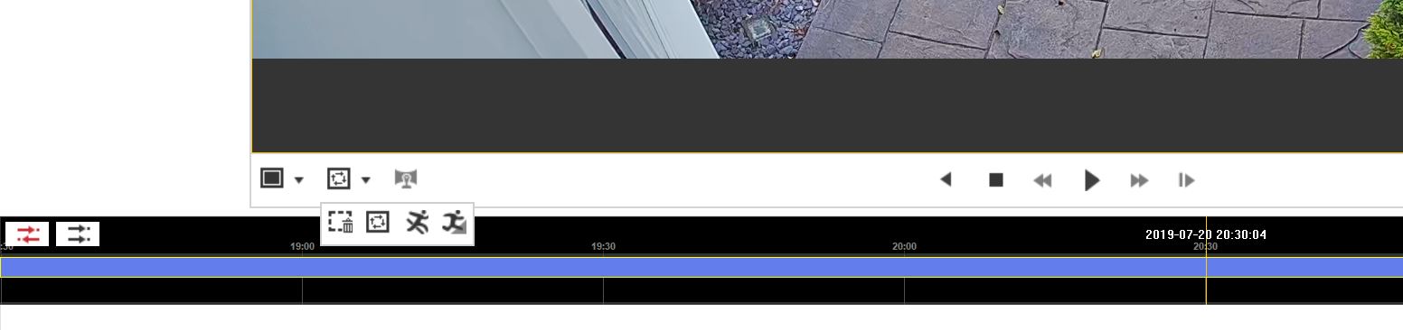

So I have my NVR set to continuous record which creates the solid blue line in playback.
On my NVR box i can see the blue bar with event markers under it. I have tried to get the markers to show on the web access playback view (via IE browser) - but there is nothing.
I put the camera to full window and click the button to show motion/events . Nothing.
Model: DS-7604NI-K1 / 4P(B)
Firmware: V3.4.100 build 180310
Camera: G1 8MP
Any suggestions? I've seen other threads with this issue but no conclusions.

As far as we are aware and from what we can see from our own testing the feature has only been added to I-series NVRs running v4.22.000 and when using Internet Explorer, we have a 7616 I-series NVR in the office which is running the latest firmware and doesn't display the event markers when using Chrome, Firefox, etc...
The reason you are seeing different results between the browser and iVMS-4200 is that the browser event controls that @Denzy screenshotted in his original post are actually doing something different to the Smart Events you have set in iVMS-4200. I tried to explain this in a previous thread - Intrusion and line crossing marks in playback mode
Basically, the motion/line crossing/intrusion option in browser playback is a live function that highlights anything that has triggered that event, whether or not you had that event enabled in Smart Events or not. So for example, if you select line crossing and draw a line on the playback that is different to the line you drew in the Smart Events settings you will get different results, this would be the same for motion in that the playback option will scan the whole image for any motion while your Smart Event settings will likely have motion detection areas drawn within the image, again leading to different results.
So the feature they are not planning to bring back is the coloured event markers for Smart Events you set in the camera's menus, but if you have access to Internet Explorer you will still be able to use the live playback event markers but these will show different triggers/markers to the real Smart Event triggers. The only way to still get the real Smart Event markers is to either downgrade the firmware or access the footage via iVMS-4200 and/or a direct monitor as both these options still support showing you the event markers.
