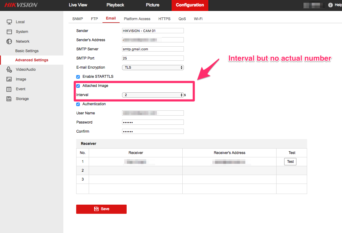

Email images (see screenshot)
We can enable Attached image and an interval but there's no mention of how many images to attach.
I think this is a badly missing feature.

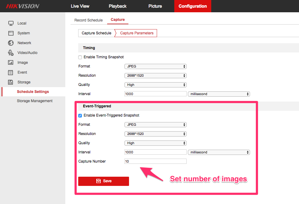

General Capture (see screenshot)
I have specified 10 images upon motion detection. Upon review it seems these are storage specific though (my bad) and not connected to the email functionality.
