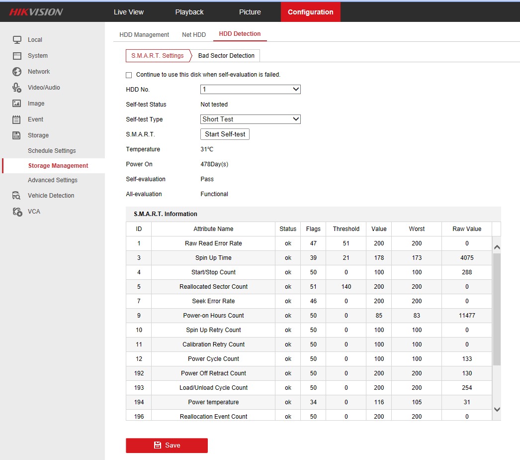

it seems to be worse if i flick through the hours of the day once or twice.
Does your NVR/firmware allow you to check your HDDs?
As live view seems OK, and a single camera should not be too demanding for the NVR, I'm wondering if there's an issue with your hard drive.
