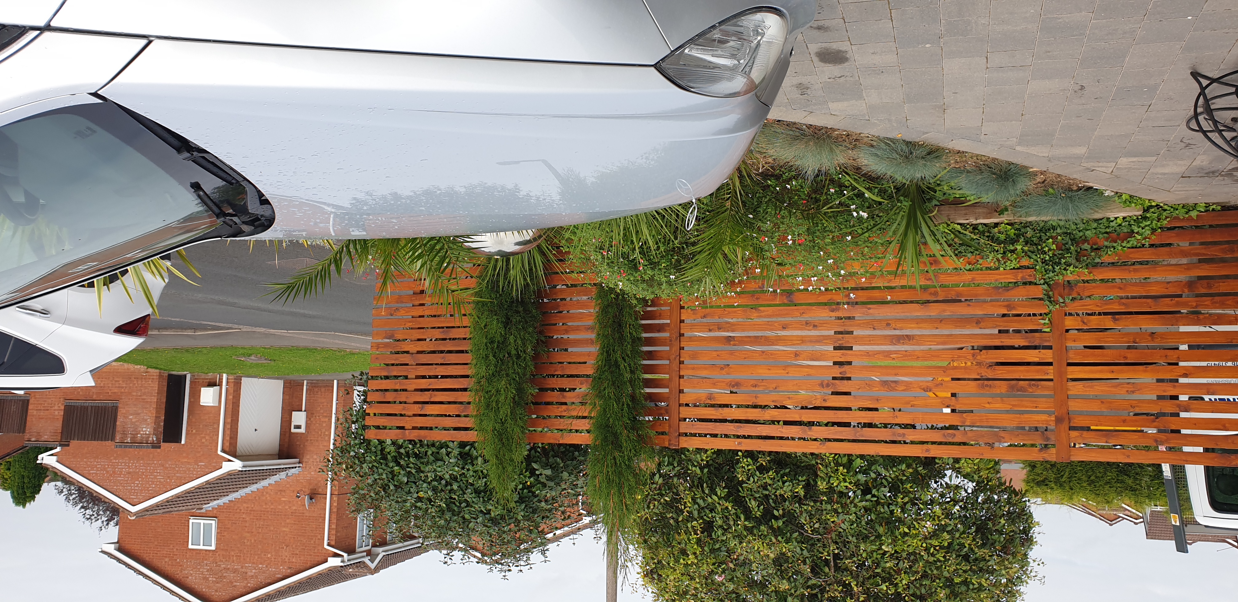

D dba7108 Member Messages 6 Points 1 Sep 11, 2020 #1 I'd like to cover the drive and pavement. Would a fisheye be suitable? I want to mount it on the fence discreetly. The 2 conifers are coming out.
Phil Administrator Staff member Messages 5,170 Points 113 Sep 11, 2020 #2 No. Fisheye cameras are awful things, especially outdoors - pretty much useless for security / identification. I'd suggest a Hikvision flat dome 25XX with a 2.8mm lens.
