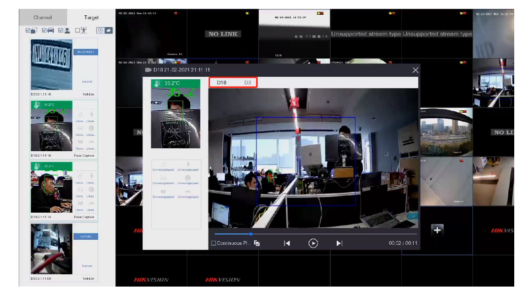

anpr is working and face detection is also working but the local gui dont get a trigger on the anpr or face capture.
the image below i just an example of what i want to see in local gui.

Hi @nwgreplica
The firmware you have found is actually from the EU portal and for the /P models. (not your fault, Hikvision do not make it clear)
You will find a similar firmware version for the non-/P models at the UK portal under this folder - portal » Product Firmware » Hikvision » ANPR » 4 Line » Non P version firmware
In regards to the GUI onscreen pop-ups, have you ticked "Full Screen Monitoring" in the Linkage action for the face detection smart event?

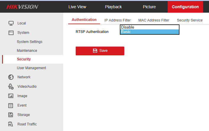

Hi codlord, I appreciate your response and suggestion but unfortunately I don't appear to have an option of 'WEB authentication' (see screen grab) so I can't really move forward with your suggestion even if I knew what the rest of your instructions involved.
Please excuse my lack of knowledge on this :-(
Robbob.
