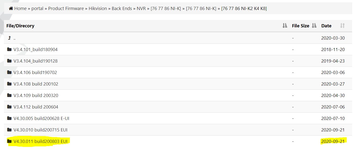

thanks a ton mate for the detailed instructions. Before I take the plunge do you reckon I should upgrade my NVR firmware to the latest ones on the UK Portal?
NVR-DS-7616NI-K2/16P- currently on V3.4.101_build180904 but the latest available is V4.30.011 build200803 EUI not sure what is EUI?! I remember you mentioned don't upgrade to version 4.... if that's the case should I upgrade to 3.4.112 in the list below?
I can't access my camera web access page anymore as I can't see the links for them under camera management option. The links have disappeared - which may be one of the other things which have been messed up. So can't upgrade their firmware, but can do it later perhaps?!
3.4.112 is the latest version of the version 3 firmware and so the interface will look the same as it does currently. The 4.30.011 is the new version 4 interface which will look completely different. Some have had issues with it. Even if you're going to upgrade to the newest version 4 - you should first upgrade to 3.4.112. Dan put up a post some time ago explaining that many of those having issues with version 4 had jumped directly to it.

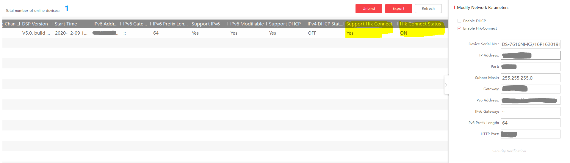

Looking it from the SADP tool, it shows Hik-Connect status as ON. Should I unbind the device and then try adding it?
No harm trying - though I'd probably do it from the NVR if possible. I honestly don't use Hik Connect much - at least not using the Hik Connect service. I use it for my own system since I have alarms and it's handy getting the notifications on my phone (and Apple Watch).

okay........ I managed to get the Hik-Connect status online via the web browser. Tried my luck as mentioned in this thread Hik-Connect - Hik-Connect Offline Issue with my DS-7732-I4(B) NVR after updating to V4.40.016 firmware?
On the NVR it does show online and shows the device has been bound. I added the device on the app and it has added successfully and I can also see it online when I log into the hik-connect.com
