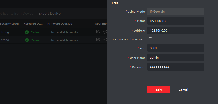

i always tought the "activation" password for the outdoor intercom was also needed for the indoor stations? i thought it was also somekind of registration password? but seems its enough to just enter the main door IP adress (outdoor) on the indoor stations? so actually the activation password can be different between all hardwares?

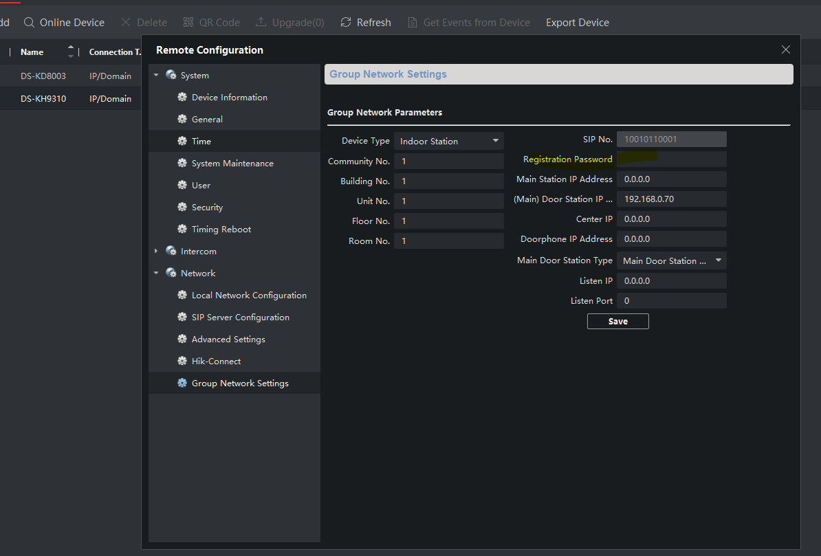

1) is also the "activation" password, actaually the password from the "admin" account? that can be changed in screenshot 1... or is it more like to activate the device once... at the beginning, so in other words, is there a difference between screenshot 1 and 2 ?

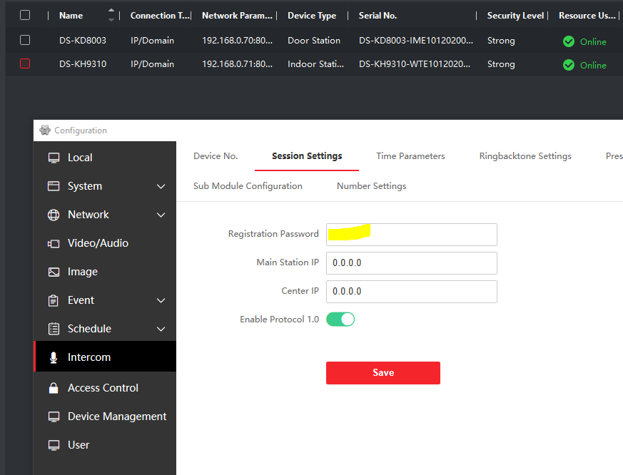

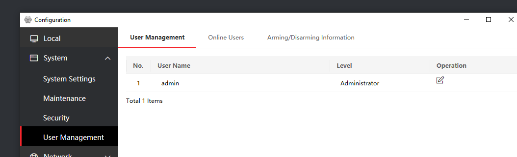

2) what is then the registation password on the outdoor station? that one is not needed? see screenshot 3 and 4 , those are not needed? i dont remember filling in those , it was a long time ago :)
thnx!
1: adding mode :
2: remote config mode
screenshot 3 : ds-kd8003 outdoor
screenshot 4 : 9310 indoorpanel
Sorry, you're right you'll need to set a "registration password" on the outdoor station to whatever you like on that "Session Settings" page, which is really just another security layer when linking it to other devices or submodules.
The password you activate the outdoor station with can be anything, it doesn't need to be the same as the indoor station. And as you say, this is just the password for the "admin" account for that device, and it's just used to activate the device, log into it, and add it to other devices / software.
When you add an indoor station to the outdoor station on its "Device Management" page (you will need the indoor station's serial number and IP address), you will be asked to enter both the outdoor station's "activation password" and "registration password" - so they are different, but both are still required.
Also, you can change the "registration password" as many times as you like on the outdoor station, as long as you can log into it and access the "Session Settings" page :)
