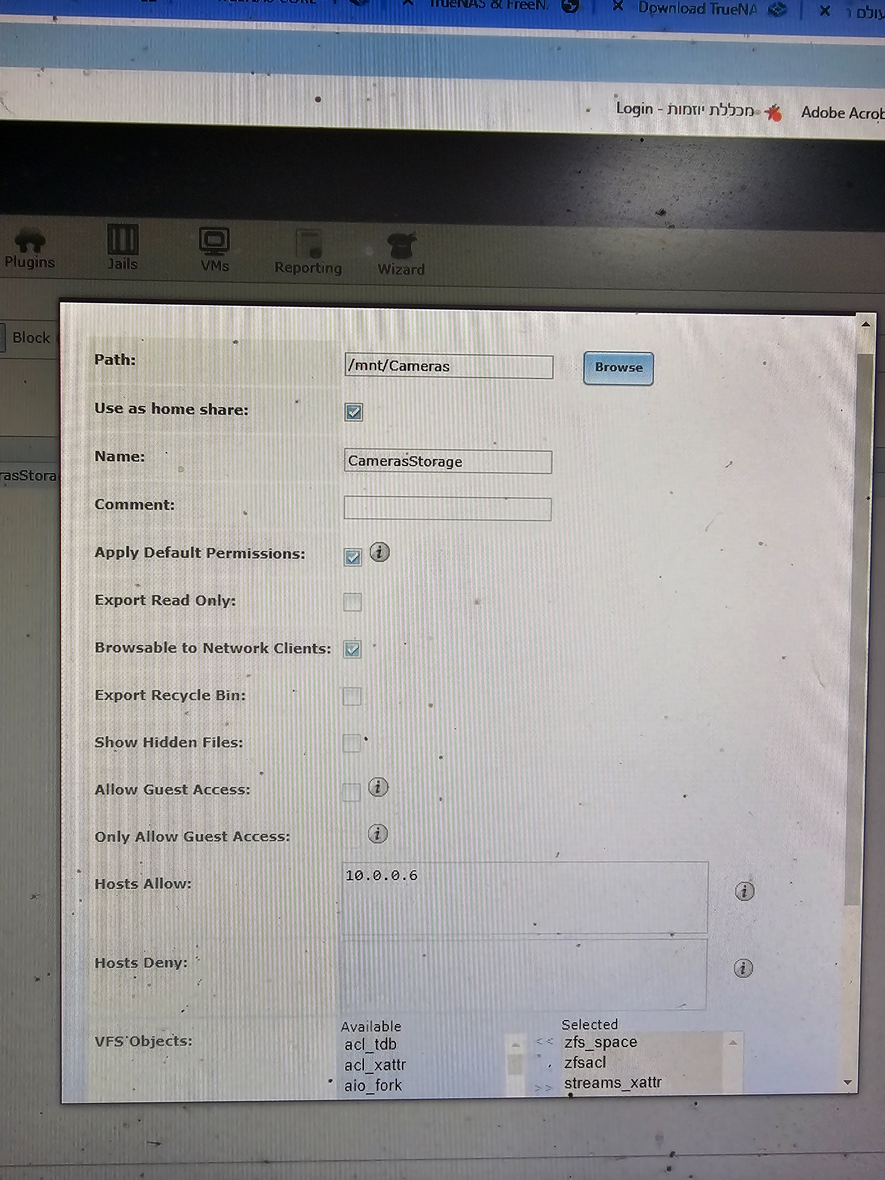

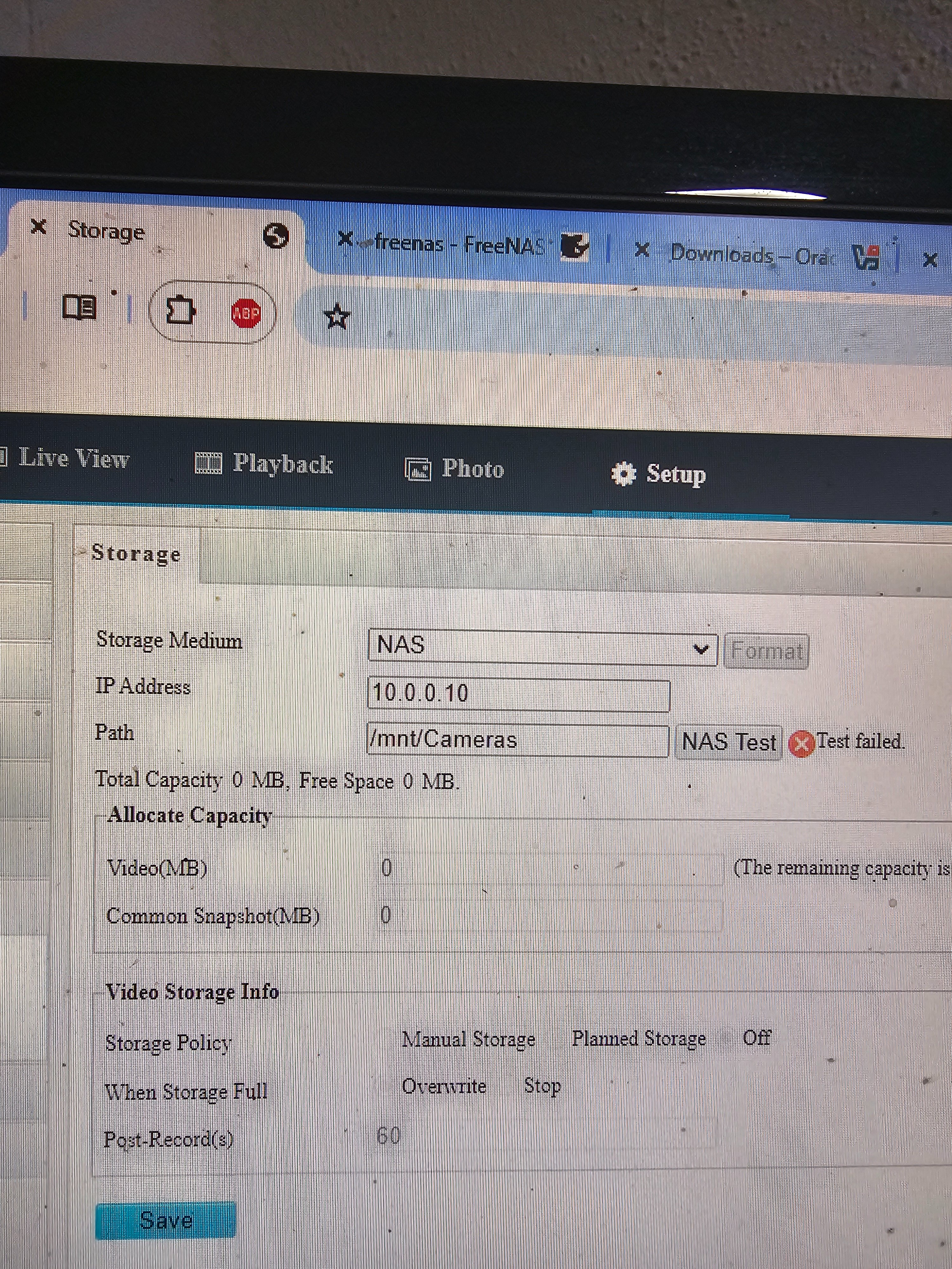

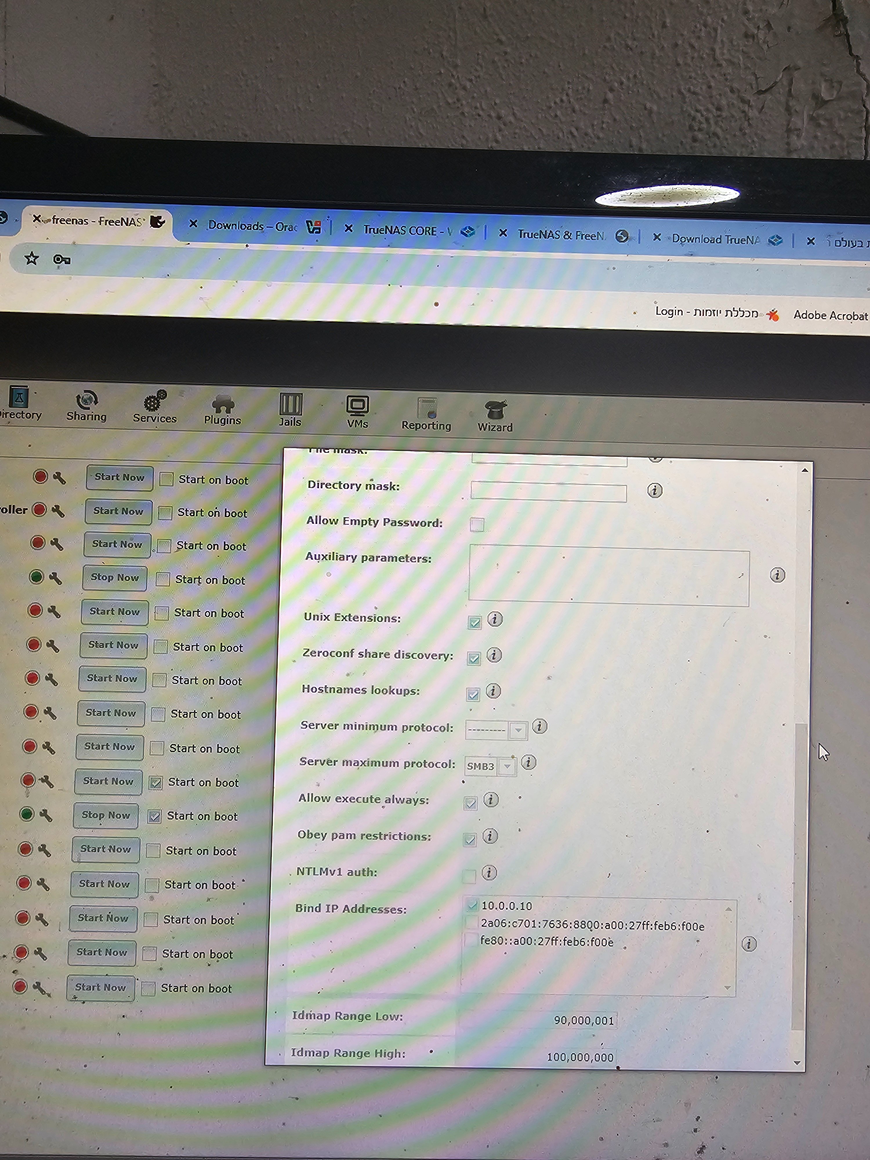

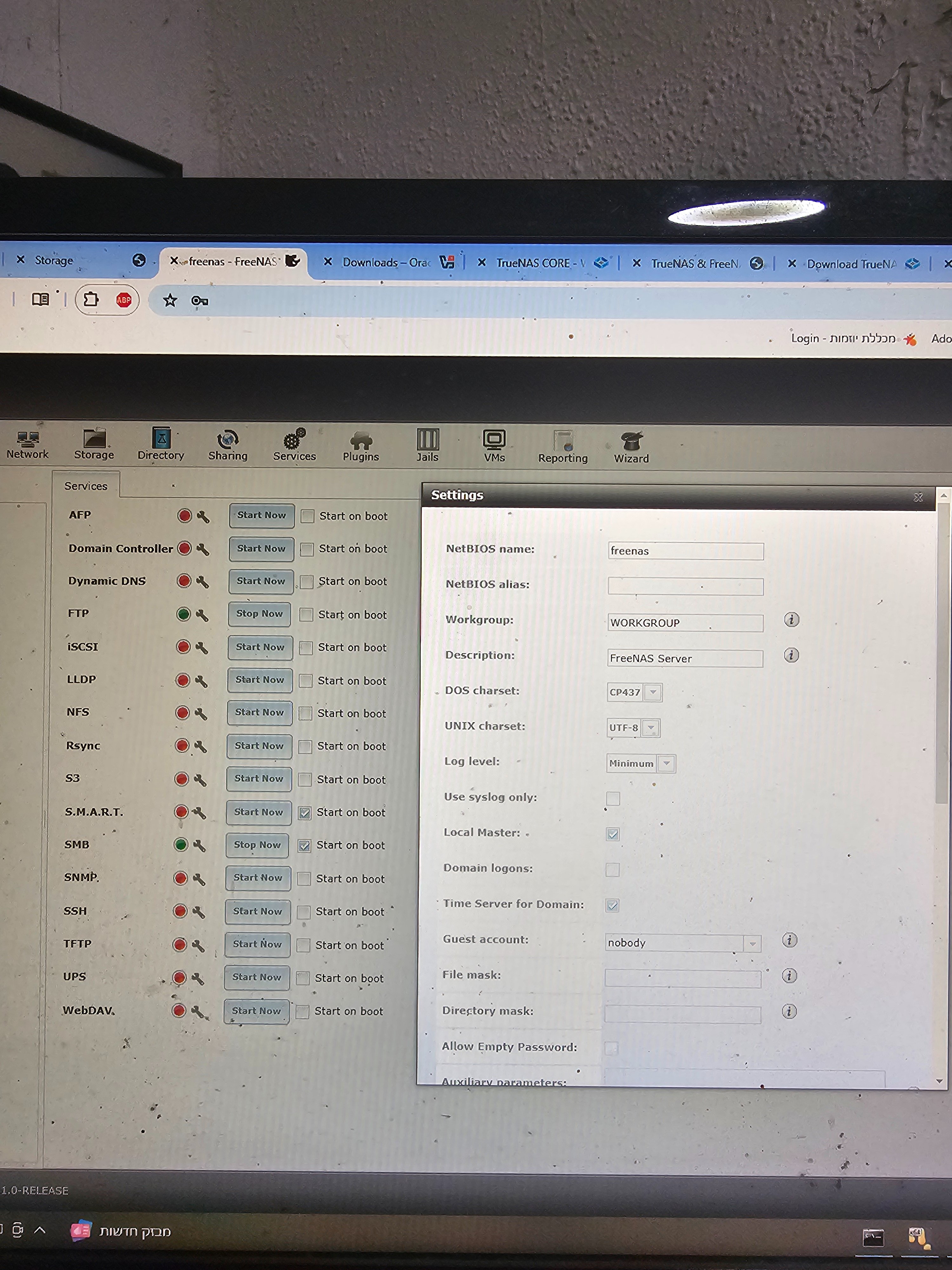

Sadly I am not following a specific guide. However, I'll add a few pictures of settings.
10.0.0.10 = the ip of the NAS
10.0.0.6 = the ip of the Camera
The sharing option is SMB

Check the port numbers of the SMB server and client are the same.

I have created a new one on a seperate server, now I've got some progress.
I am able to create a text file from another computer but still having an issue with connecting the camera to the NAS.
When entering the ip address and path I still get an issue of failed test.
Current IP: 10.0.0.9
Current path: /mnt/Storage/Camera
It is now with 8 GB RAM.
I THINK FOUND THE MISSING PIECE!
I turned on NFS and suddenly was able to finish the connectivity test successfully!

I enabled it on the NAS.
I also enabled FTP in hopes it would help.
