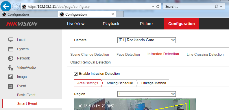

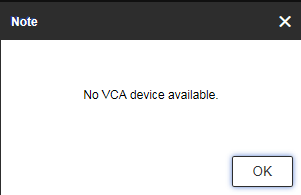

I've replaced a failed Qvis DVR with a replacement Hikvision 7208HUHI-K1, and one new Hikvision camera.
I plan to replace the other cameras over time.
Trying to get Intrusion detection and getting alot of noise.
Seeing and reading lots of conflicting information on what the parameters can be for this setting so getting a little confused.
I understand that I need to have VCA enabled for the cameras' that I wish to use with intrustion detection.
I think that you can only do this directly on the DVR itself, in the main admin menu, under each camera.
Is there a way to configure VCA through the Web interface, or via iVMS?
