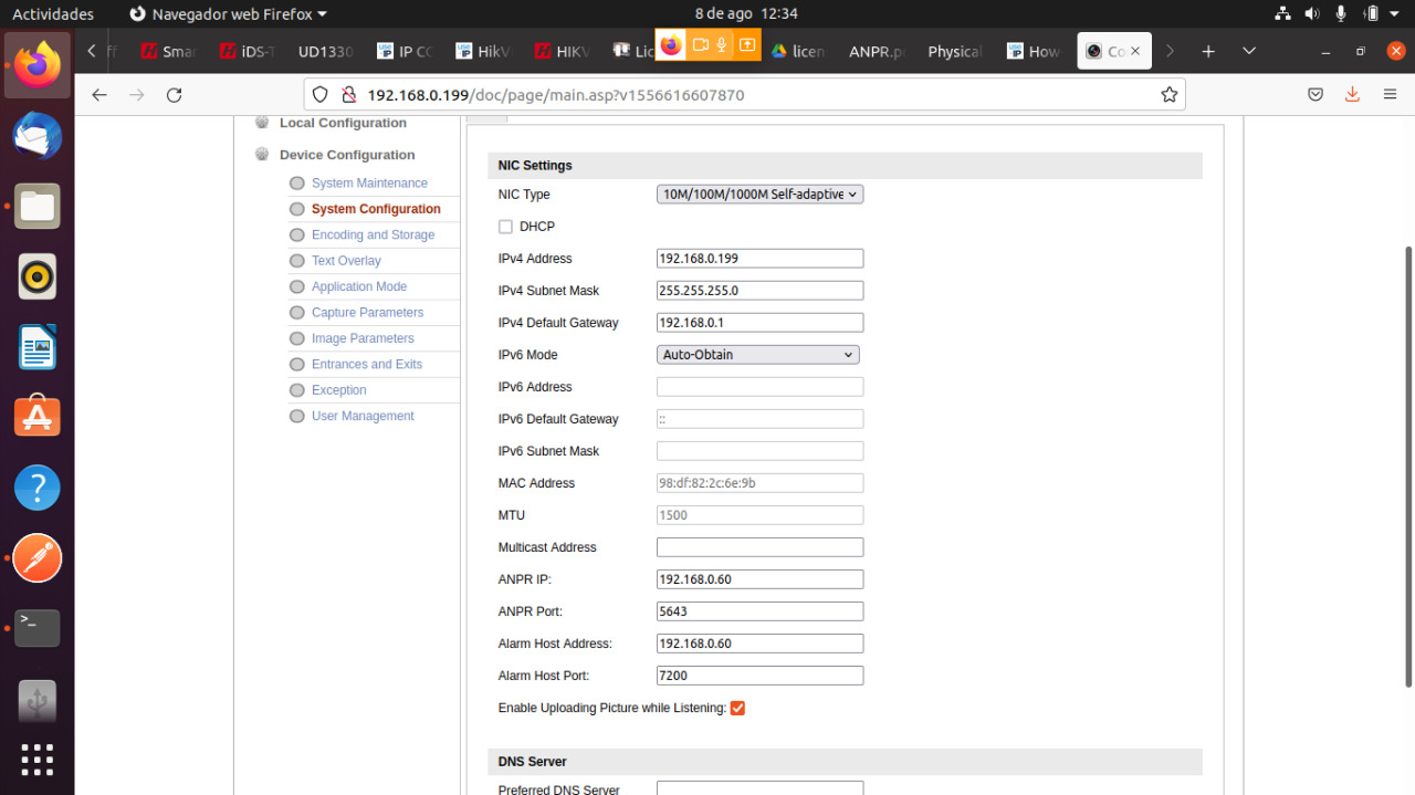

I'll attached my configuration for give you the big picture.

Hi @tul1
The document you are looking at is specifically to do with ANPR API files which will only confuse you if you are just trying to do a basic ANPR setup.
Follow this user manual (p58-59) and this YouTube video for the basics of ANPR setup.
