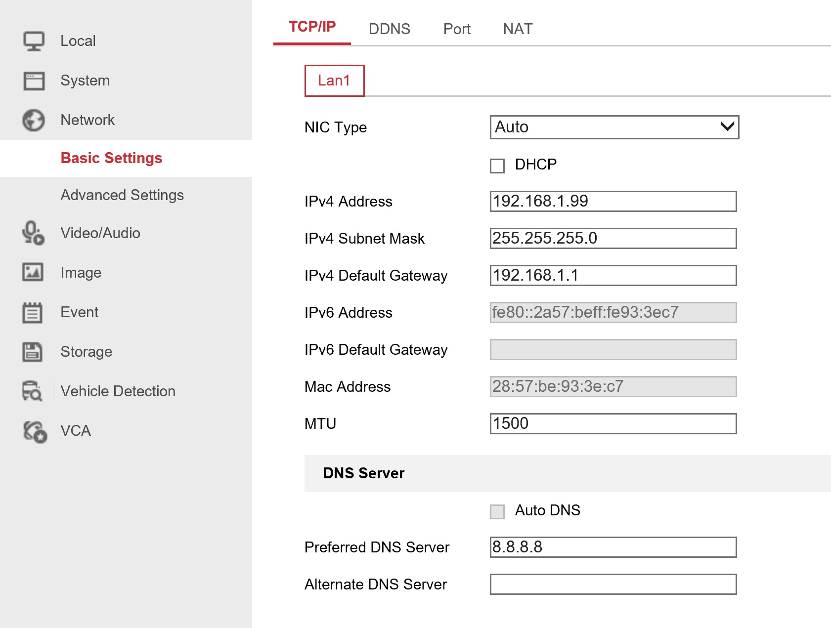

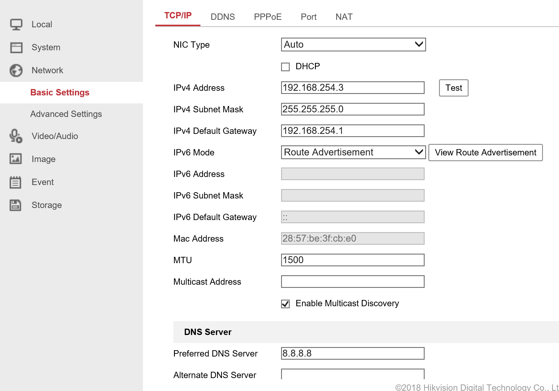

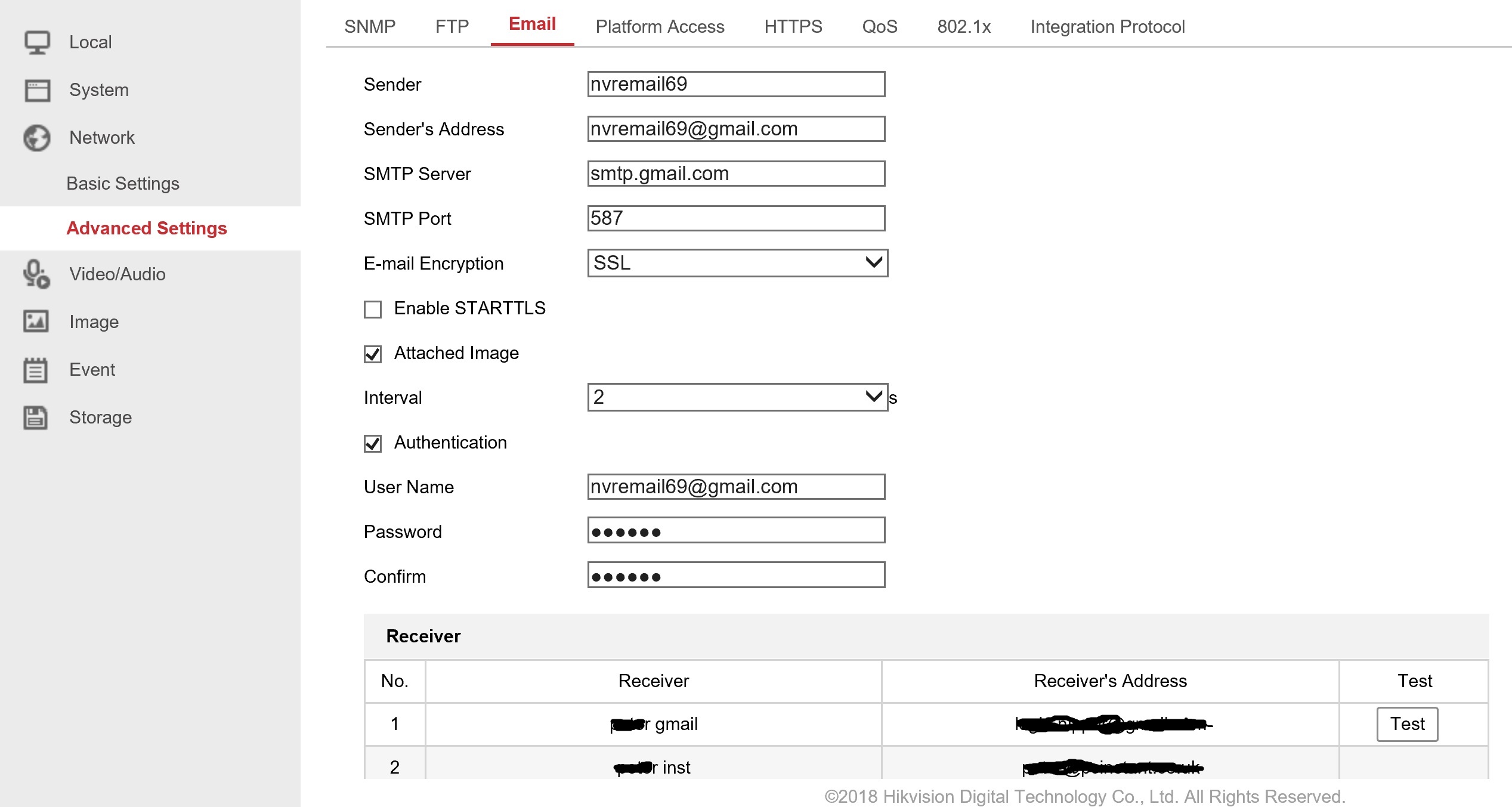

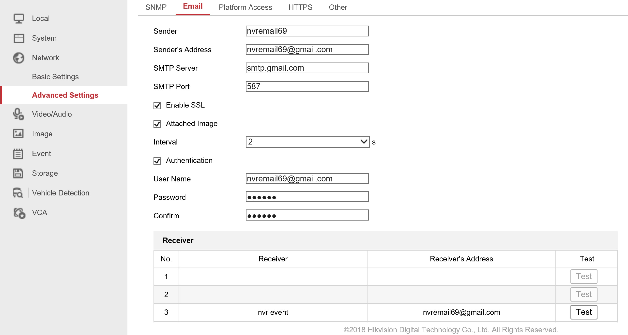

Any advice please....I have attached images of the network settings I currently have. The nvr settings sends emails....the cam ones do not.

please give image from your alert setting on your camera and NVR,
for example if you setting line-cross event check your setting related to arming alarm about this event, and make sure you checkbox the send email in your camera too,

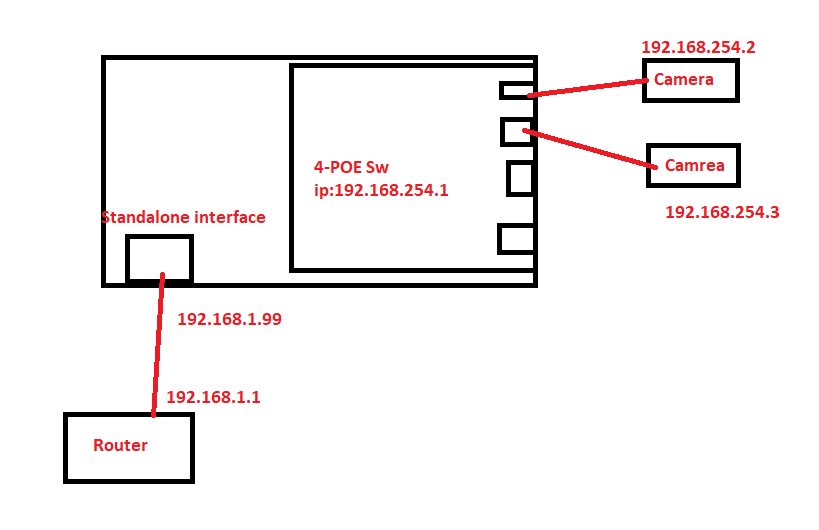

btw about your networking:
i assuming you connect this two camera to your 4 port POE switch of your NVR and stand alone network link of NVR to router which has a access to internet. according to your ip config your routers probably NAT packets with source ip of 192.168.1.x (which should be do so any device with ip of 192.168.1.x or better explanation 192.168.1.0/24 have access to internet) but because your camera connect to NVR first then router so they have ip range of 192.168.254.X and should NAT to 192.168.1.99 first and then goes to your router, however i think NVR do this by default, follow these step for test your internet access from devices which is connected to NVR switch:
1.connect your PC or laptop to one of 4 port of your NVR (which already two camera should be connected to this).
2.set the ip of PC/laptop in range of NVR and camera ip.s which in your scenario could be something like 192.168.254.99 or 192.168.254.100 , ........
3.in windows OS in search bar type CMD and open Command prompt then type ping 192.168.254.1 (if u do these step correctly you should see reply from 192.168.254.1 with time=x
4.then ping 192.168.1.99 (which is stand alone interface of your NVR according to your images) see this has reply or not.if its ok follow step 5 if not send image probably your NVR could not NAT packet trough switch to router
5.ping 192.168.1.1 which again according to you image it would be your router IP. if you see reply go step 6 otherwise send image
6.ping 8.8.8.8 or 4.2.2.2. again if you see reply this means your cameras have internet access and this issue its not related to your network addressing otherwise send image.
note: please consider i assume these scenario according to your current config in your image attachment it found that :
a.your network camera ip range should be 192.168.254.0/24 (192.168.254.X)
b.your router IP range should be 192.168.1.0/24 (192.168.1.1)
c.the single network interface of your NVR has ip with 192.168.1.99

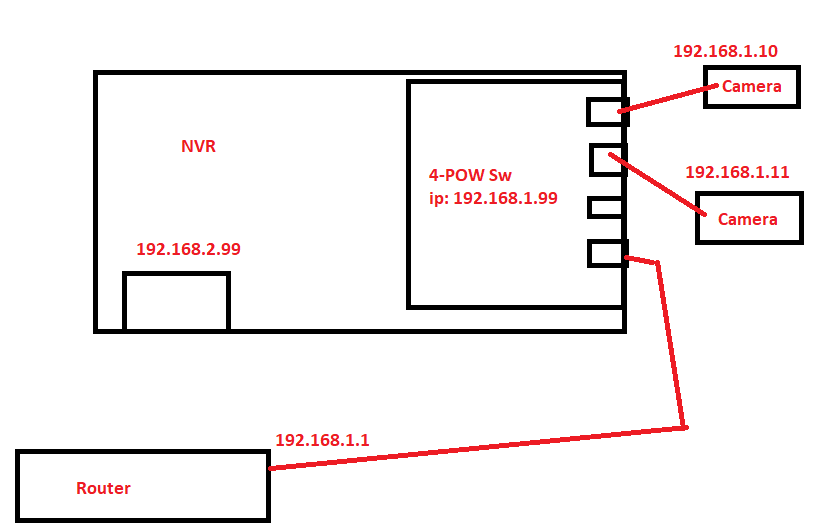

i have solution for you without need to use static route!:
1.you need to disconnect and change ip of your NVR standalone network interface to another range like 192.168.2.99
2.in camera management setting of your nvr change connection type form plug and play to manual (do this on all 4 port)
3.set 2 static ip in range of 192.168.1.0/24 (your router range) on your cameras: i.e cam1: 192.168.1.10 and cam2: 192.168.1.11 with subnet mask of 255.255.255.0 and remember set their gateway your router ip which i think would be 192.168.1.1 (you could SADP tools for doing this)
4. add cameras to NVR by manual! default port for hikvision camera is 8000)
5.now connect a cable from your router to NVR 4-port Switch.
*be advice with this config your camera can access to internet and no static route needed because they are in range of your router and their default gateway is your router how ever remember in this situation you nvr can't access through internet because unfortunately in this model i think only stand alone interface of NVR can be access to gateway and not its POE switch.
*you could test this network by connecting a PC or laptop to 4Port NVR switch and test the internet connection.

*generally i agree with @StuartW if you get a proper router it would be so much better however for two camera issue about bandwidth and streaming had not a serious impact in your lan network!
i attach two diagram based on your current network i think its clear what u should with these network diagram number 1 is your current config and number 2 is what you should do.
the reason i said that probably your nvr cant access to internet is i think this NVR only allow you to set default gateway on its standalone side (192.168.2.99 based on pic2). if you tell exactly what's your router and how u access through internet i could help more by do some conf. in example if router be a really router :) not a puny one XD u can also connect stand alone interface of your nvr to another port of router and set two ip like set 192.168.2.1 on your router and 192.168.2.99 on your NVR by this your nvr have internet access too however i do not know about your routing and how you access internet?! (idk how you have a router which could not set a simple static route on it!!!)
about hik-connect: according to your explanation i think you connect NVR to hik connect cloud and you connect to your account and see your video right? by do this changes you could also connect to camera via hik-connect but this time you should contact them directly not by nvr which means you should enable hik-connect service on your camera.
