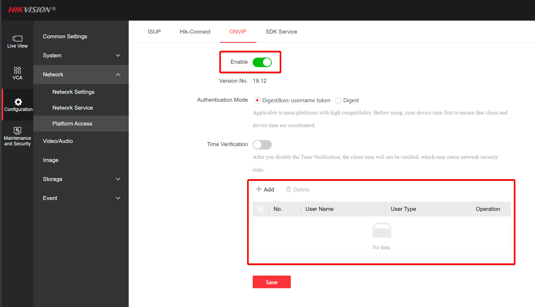

Hi @midisama - you need to enable ONVIF on most cameras and create an ONVIF user(username and password), and then use those user credentials to add the camera via ONVIF.
For new Hikvision cameras, you can create an ONVIF user in Configuration>Network>Platform Access>ONVIF:

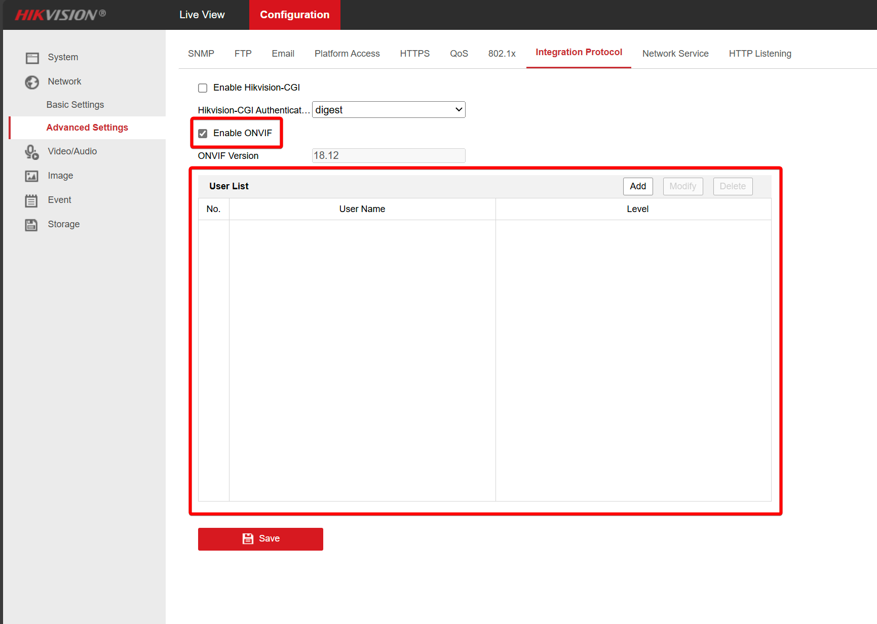

For older Hikvision cameras, you do it in Configuration>Network>Advanced Settings>Integration Protocol:
