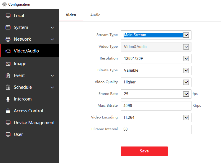

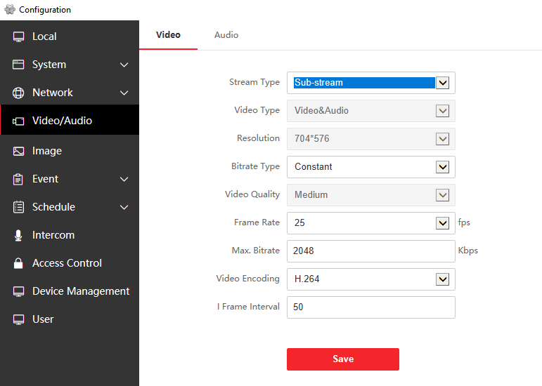

Check that you have set the highest resolution option for all streams as well:
In iVMS-4200, go to the device management page, and click on settings (the cog button) for the KD8003, and then go to Video/Audio>Video.
Hello @Kyle,
thank your feedbacek, yes I have setup see attached file.
regards Petr

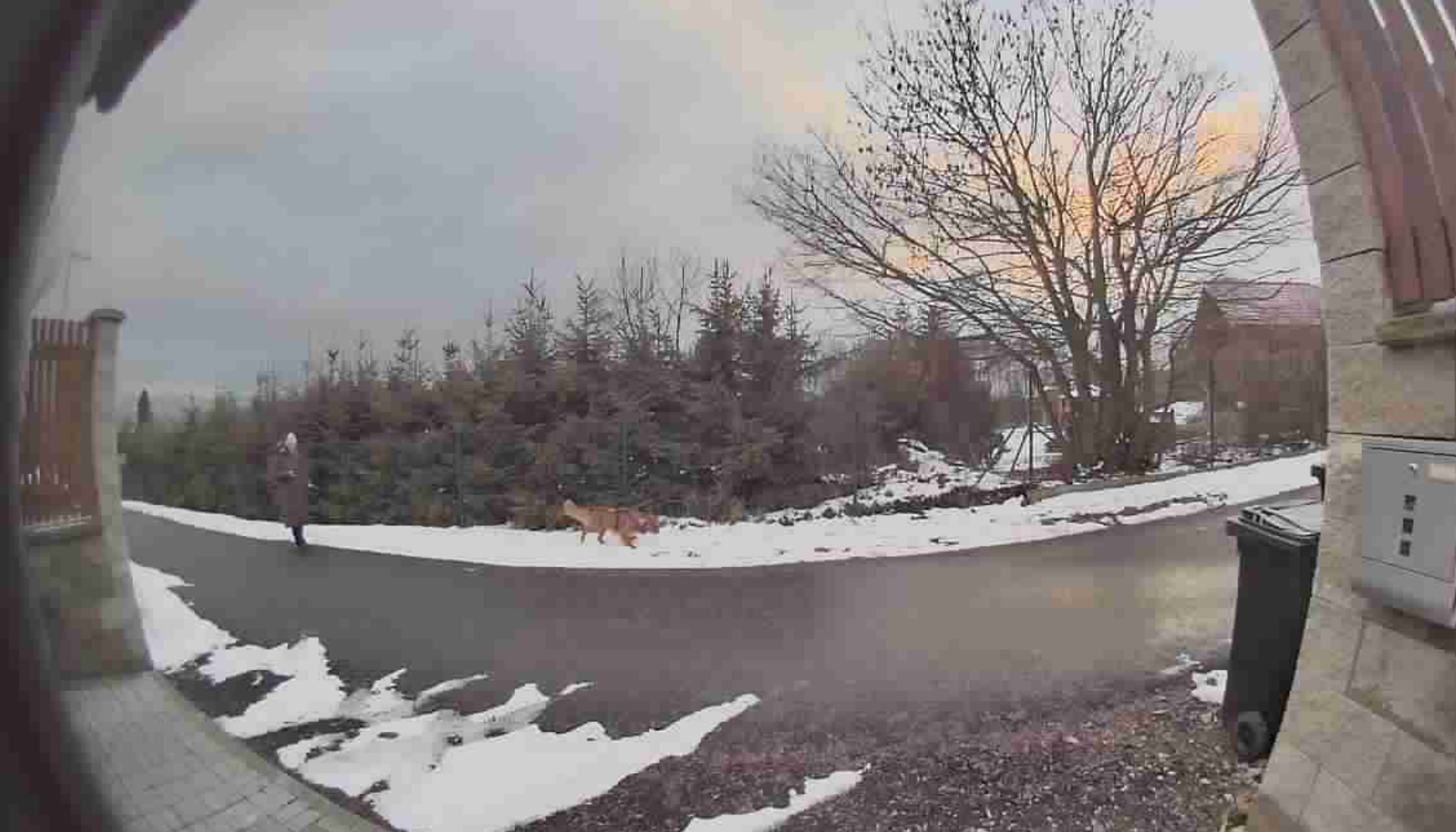

Hi @pemen
I can't see any other setting to improve the quality of the pictures that are sent, so I think you are receiving 2MP pictures but these just seem poor quality compared to the higher-resolutions that are more common now.
Are you able to share an example picture to show the quality of the picture you are seeing?
I don't know what do you mean , how to share an example picture to show the quality of the picture ?
Sorry, ignore me, I didn't see your third attachment in post #3, which is what I meant.
It looks like it's taking the picture from the substream.

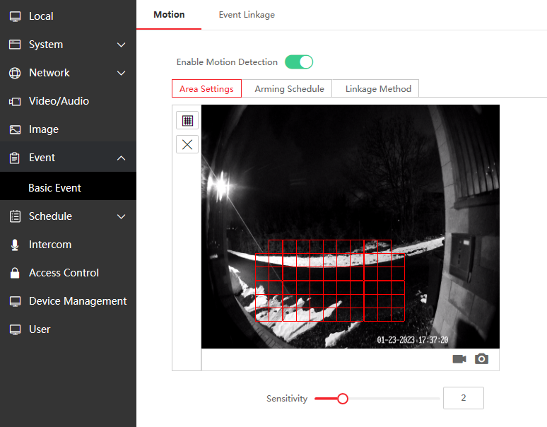

Can you show me where you set the motion detection up to send the picture in iVMS-4200, please?
see attached file
petr

In configuration of KD-8003 I cannot change resolution of sub-stream, like as @pemen shows in post #3.
