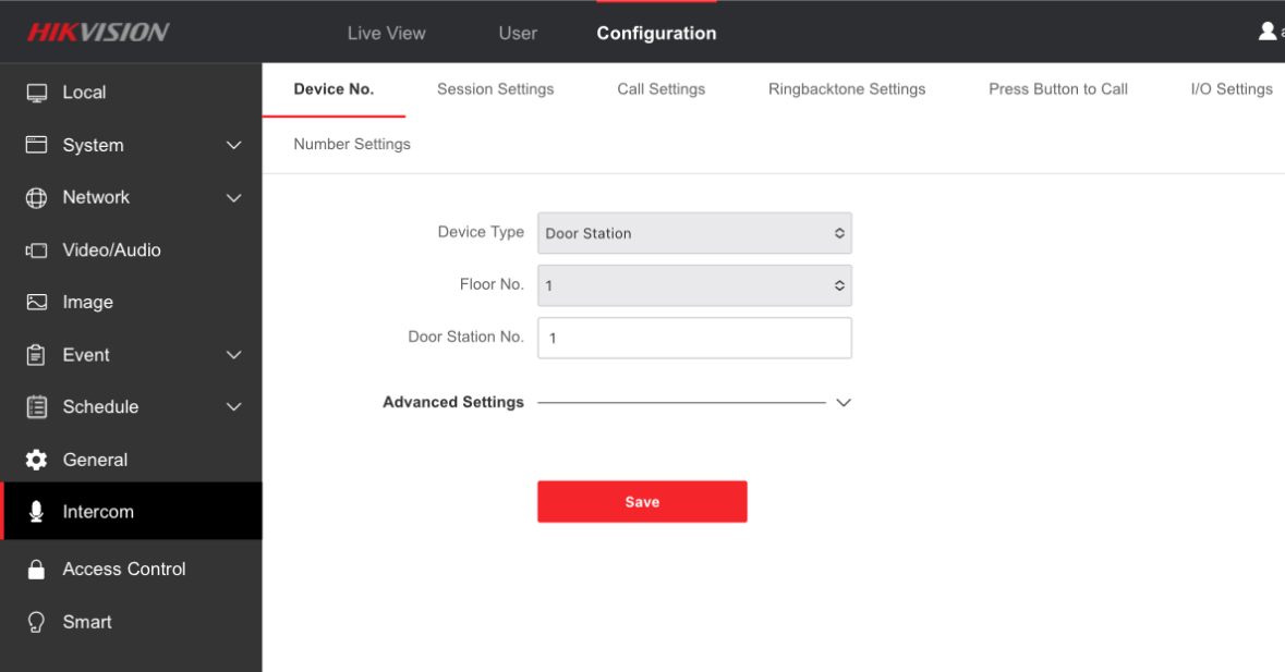

F friendodevil New Member Messages 1 Points 1 Dec 5, 2024 #1 Logging in to the DS-KD8003, I’m unable to see Password Settings under the Intercom menu and am unable to set the door unlock code. How do I enable the menu? Attachments IMG_0980.jpeg 104.6 KB · Views: 26
trempa92 Centurion! Trusted Member Messages 198 Points 28 Dec 10, 2024 #2 You cant, you have set door station no 1. That means its in subdoor mode aka 1st extension and it will copy password from main door station. If thats only one in system, change from 1 to 0 in door station number
