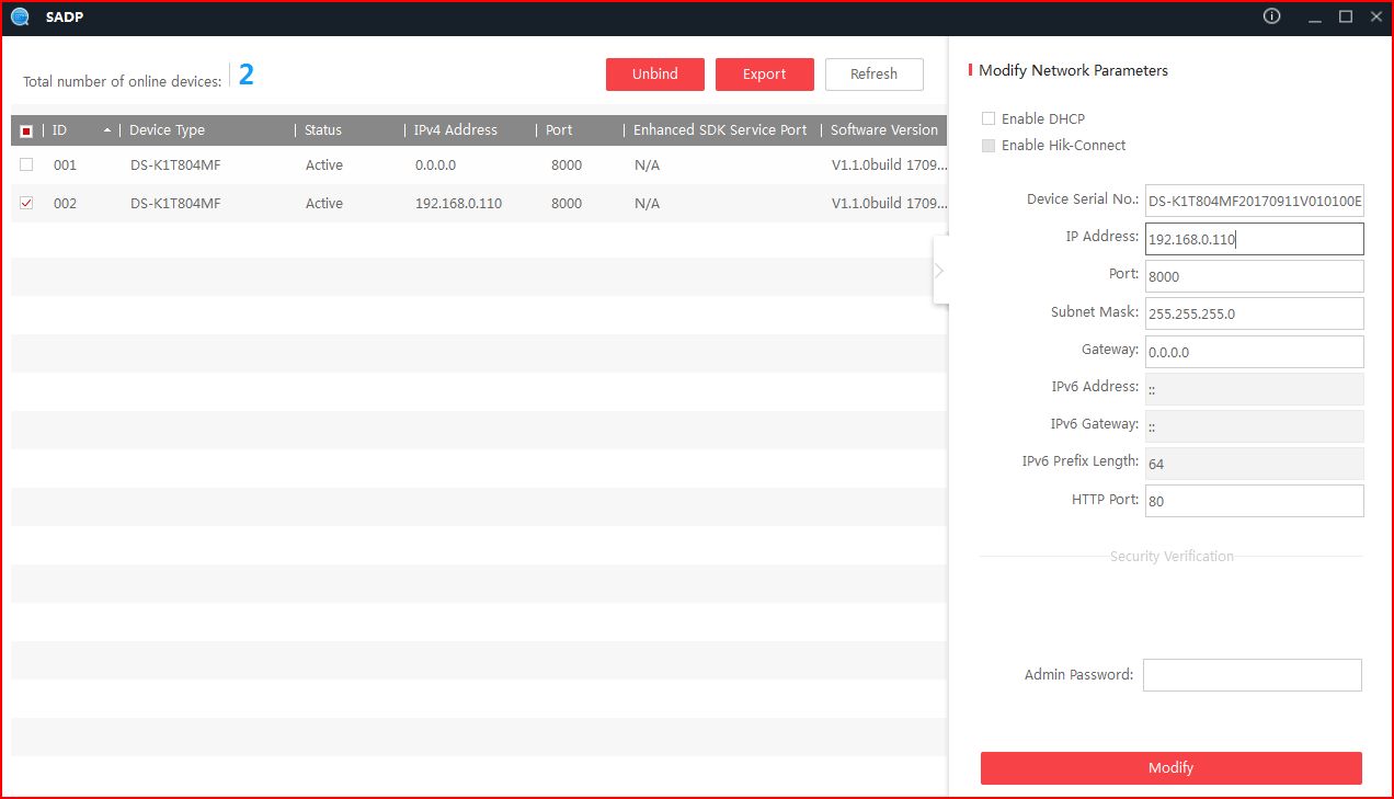

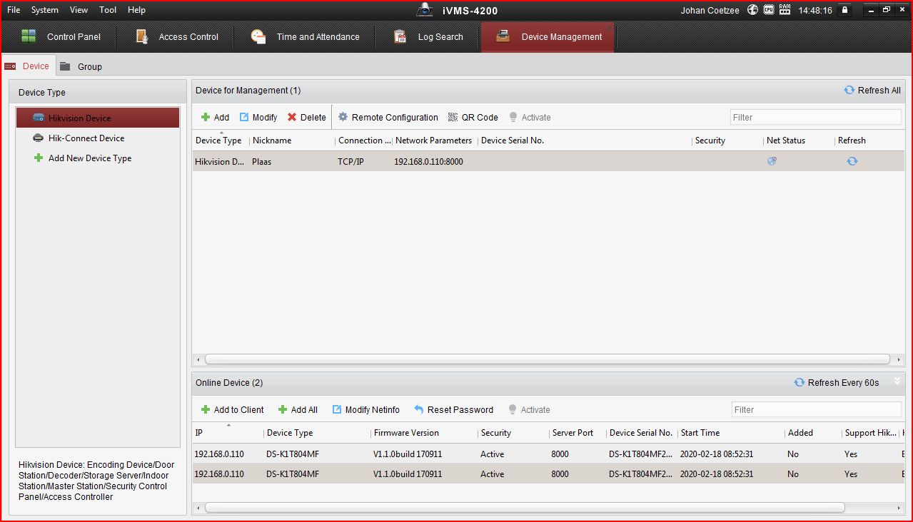

Attached is the pictures as requested.

My immediate thought is that the gateway field looks incorrect. Launch 'commandprompt' on your PC, type 'ipconfig' and then hit enter when its open, this should list your gateway address which you need to fill in the SADP network parameters.
When are you getting the password prompt for iVMS-4200? There will be two different user/password combinations needed in the program, one is for the superuser password that the program will ask for upon launch and you will have set when you first installed the program. The other is the device password which you should have also set yourself and the program will ask for when you try to add a device, here's a link to our article about the Hikvision device passwords.

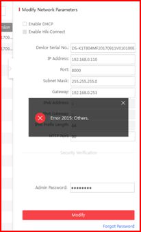

When I insert my Gateway address, it gives me this error: Error 2015: Others

That's maybe to do with the password that you're trying to set. Try a password that only includes letters and numbers and see if that makes a difference.
If not, try inserting the device's listed IP address into Internet Explorer search bar and see if it lets you set a password this way.
