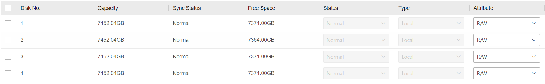

I've finally gotten around to purchasing the drives to go in my new DS-7716NI-M4. The NVR is running V4.63.005 build 230512 and I've installed 4x WD Purple 8TB drives, all showing normal status and correct capacities.

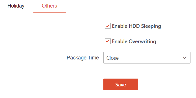

When I go to Storage > Advanced Configuration > Other, the Enable RAID option is absent, it's just completely missing even though the Help page states I am in the correct place to find the option.

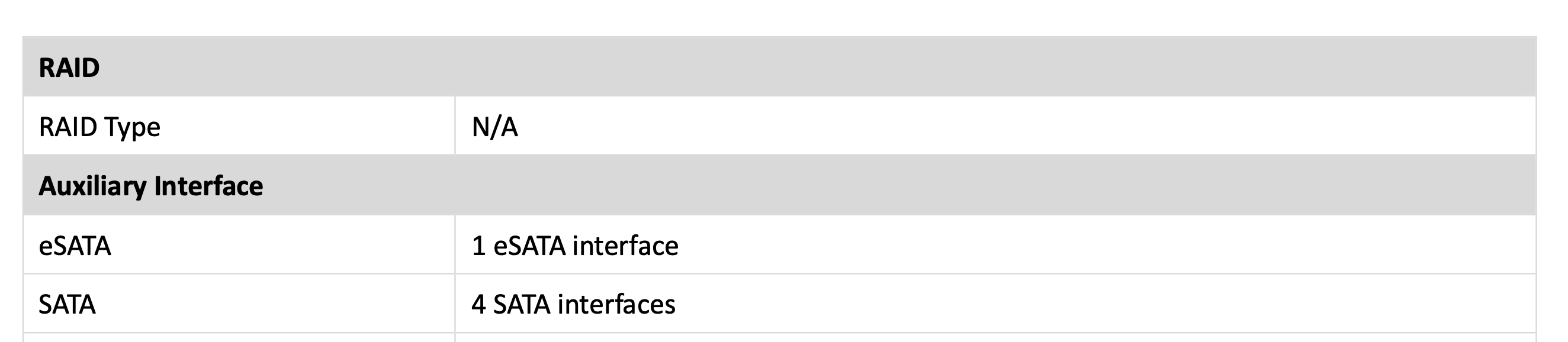

Looking at the data sheet that model does not support RAID. The screenshot below is from the data sheet. The Help pages are not necessarily model specific; they sometimes show features that aren't applicable to the model you have and often fail to show features/options that have been introduced in more recent firmware updates. I think it's the 9000 series that have a RAID controller - the 9632NI-M8 for instance supports 4 RAID arrays and RAID levels 0, 1, 5 and 10.
Most bizarre as I'm sure that the datasheet for the 7716NI-I4 and M4 used to say RAID supported as that was led me to picking it but ho-hum.
