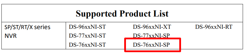

Thanks heap for the reply. Is there anywhere I can search if I have the latest firmware for this australia version?
It might be V3.4.5 Build190715 - the release notes on the other versions in this folder suggest this is the firmware for your unit:
You may then be able to enable Hik-Connect (it might be called "EZVIS Cloud P2P" on your unit) in Configuration>Network Settings>Advanced>Platform Access.
If you can, set the server address to litedev.eu.hik-connect.com.
Then, try adding your NVR via its serial number to your account in the Hik-Connect portal, as per step 2 onwards here.
Thanks yeah I do see that but I think it requires port forwarding with the version im on. ill have a look at that firmware you suggest. thanks mate
Sorry, I missed that you're using Australian firmware - I wouldn't try the above V3.4.5 firmware as it's on the EU portal.
