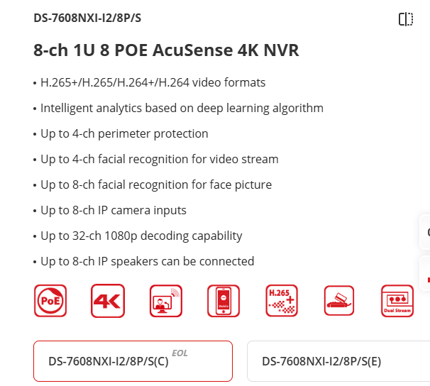

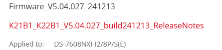

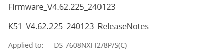

Hi... it looks like there are two revisions (C) and (E) of that NVR... do you know which revision you have?

It's the "C" version. Silly me. And it's on the V4.62.225_240123 firmware. Why on earth have the same NVR in essence, but with some difference that means different firmware. Thank you for your help.
