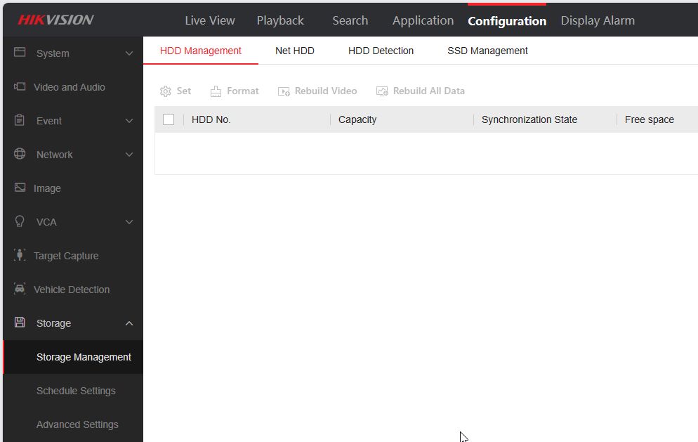

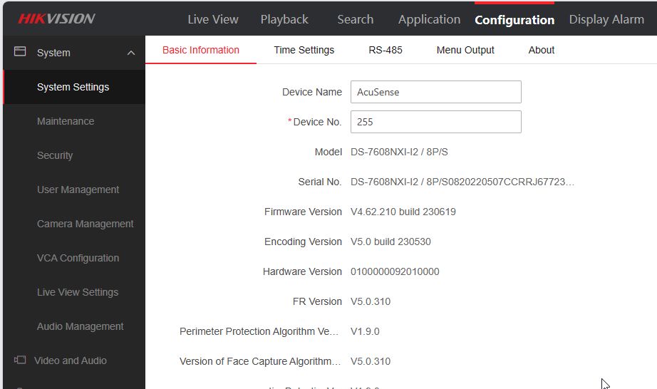

Thank you for your answer, but it is something very strange here :) .... I have discussed with the NVR supplier and they showed me some pictures with the new hardware model (C). It is the DS-7608NXI-I2/8P/S(C), still, the cloud option on version 4.62.210 is missing on storage management. Am I missing something?
Thank you

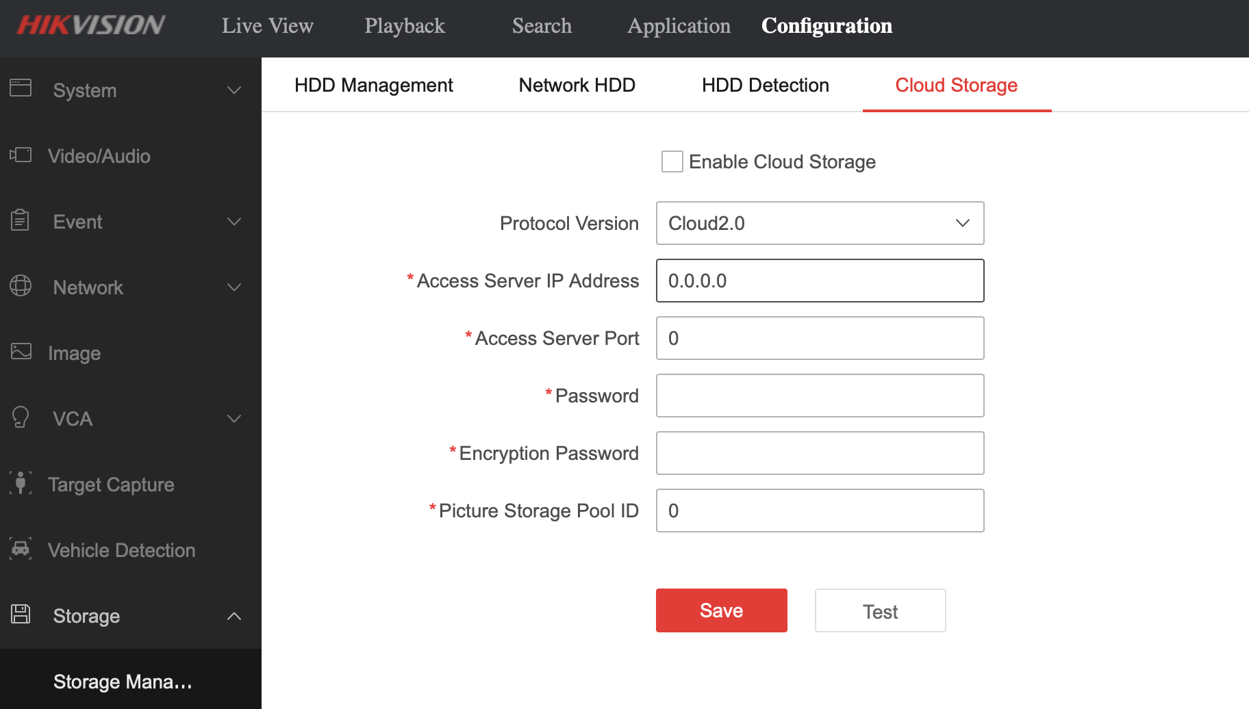

I'm not sure. Have you confirmed that Cloud Storage is an option on that model? Maybe it's just not supported.
On my M series there's nothing visible in the local menu but Cloud Storage is an option if I go to the configuration on the web browser where I have a separate tab for it:

Unfortunately it is hard to confirm something :( due to support level and I couldn't find anything useful on Hikvision web site. I will open a support case and maybe I will find out what I need. Thanks for help.
Hi @LiviuStrati
Just so you are aware, we have had questions before about the Cloud Storage option shown in @JB1970 screenshot and when we've spoken to Hikvision support they've confirmed that confusingly this feature is not actually Cloud storage, they just use this term to describe recording to a secondary back-up Hikvision NVR.
Hikvision does not offer a proper built-in Cloud recording solution for any of their NVR models.

Thank you for clarification ! At the end of the day secondary back-up might work also for me.
