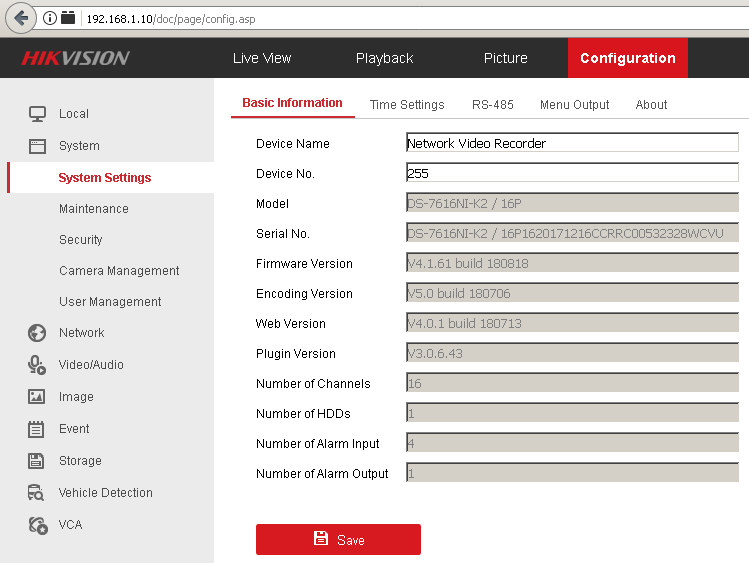

I have loaded V4.1.61 build180818 onto a DS-7616NI-K2/16P testing unit. So far everything seems to work. I've never used V4 in a live environment though. Using Firefox v54 as web GUI.
Firmware used
This firmware loaded on our DS-7616NI-K2/16P test unit. Reverted back to V3.4.98 build171121 after testing.
I'll try it again tomorrow and update you. I only tested line crossing and email alerts. Not sure if all functionality works.
I am surprised that your -K series NVR will even allow you to load -I series firmware :confused:
Hi Phil see attached. So far I've tested adding/removing cameras, installing HDDs and initialising them, motion detection and line crossing with email alerts. I've also reverted the firmware back with no issues. This is our test unit so if you'd like me to try a feature with v4 installed let me know.

To answer your question, I had firmware V4.1.61 build180818 running on a test 7616NI-K2 unit and I didn’t run into any issues on the cursory testing I did. I was able to revert the firmware back to 3.4.98.171121 without issue.
I haven’t seen anyone else try it on the forums for other K series models. Bricking your NVR, voiding the warranty, POE issues, compatibility with IVMS are just a few of the potential pit falls.
