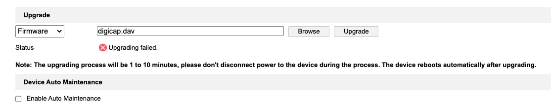

If I try to upload the firmware I get an error message:
I've tried 3 different browsers so far with the same result. Any ideas?

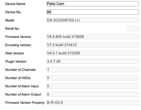

What's the firmware version property number please (on the System Settings>Basic Information page)?
Ah OK, it's one of the original G3 versions of that camera - your firmware is up-to-date already :)
All of the versions that have been released can be found here.
Right got it........ thanks for confirming....
Flipping weird but on my Mac if I try to access direct links like that one they always fail.
Ah ha I sorted it I can access the portal if I turn off AdGuard DNS and turn off all browser extensions (and use Microsoft Edge) Sheesh.
