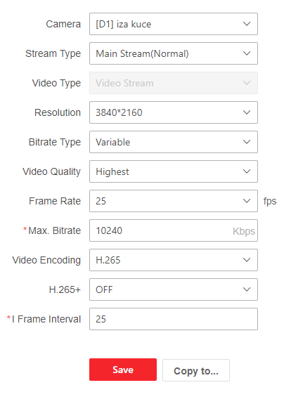

Well with DS-7616NI-I2 (V4.51.025 build 210927) and 8port PoE switch, all five cams are working perfectly.
H265+ is still problematic so this is my current stable set for all cams (picture).
I have 2x2TB WD purple, and all recording is triggered by basic motion.

well I did try but then hikconnect is struggling with live view and event playback, I only have 30Mb internet upload.
Between 16384Kbps and 10240Kbps my eye doesn't see any difference :)
