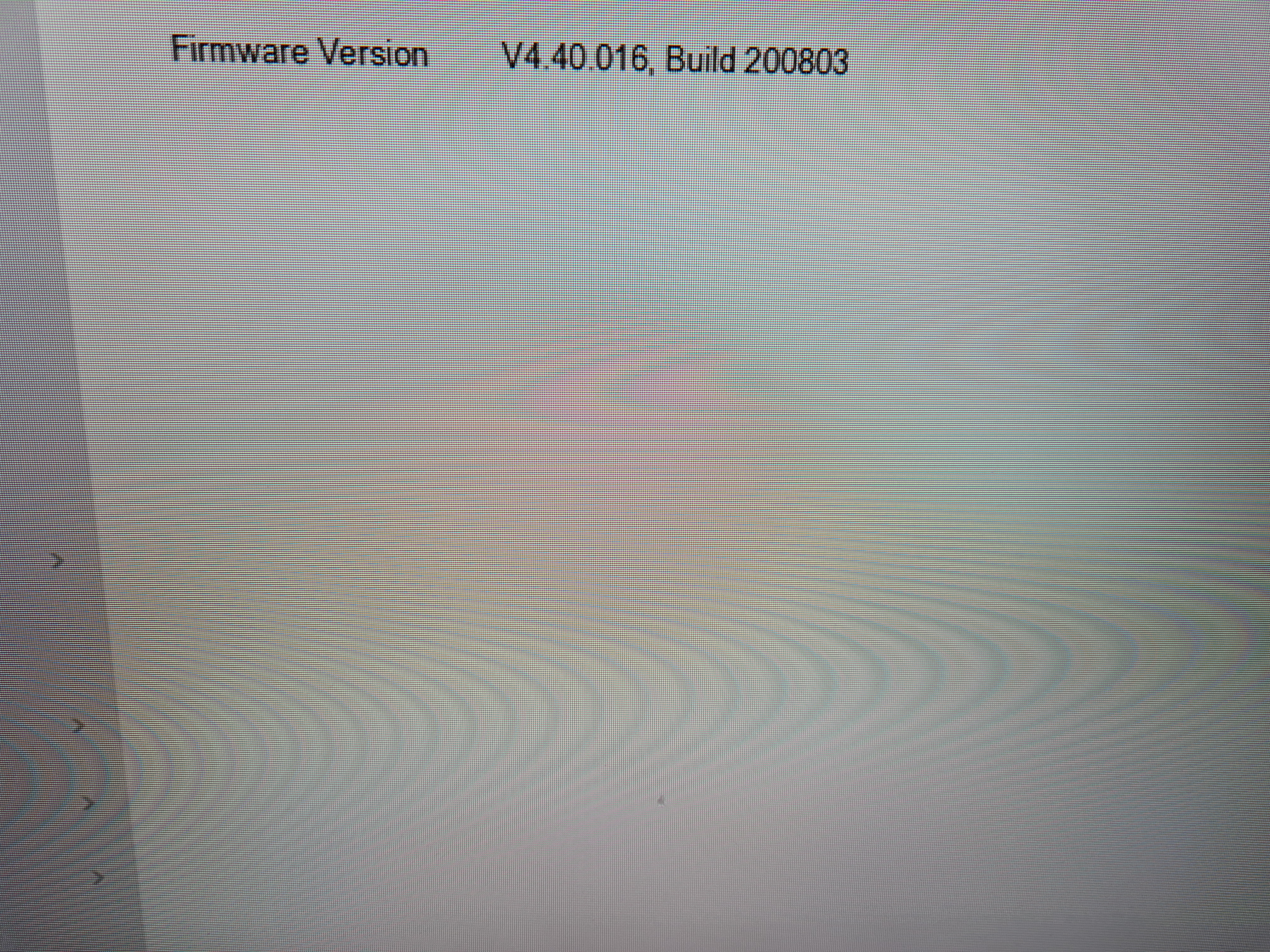

This is my current version.

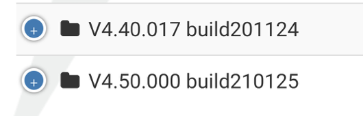

Which one do I need to download?

Great mate thanks. Unsure what it gives me that I didn't have. But at least it's upgraded.

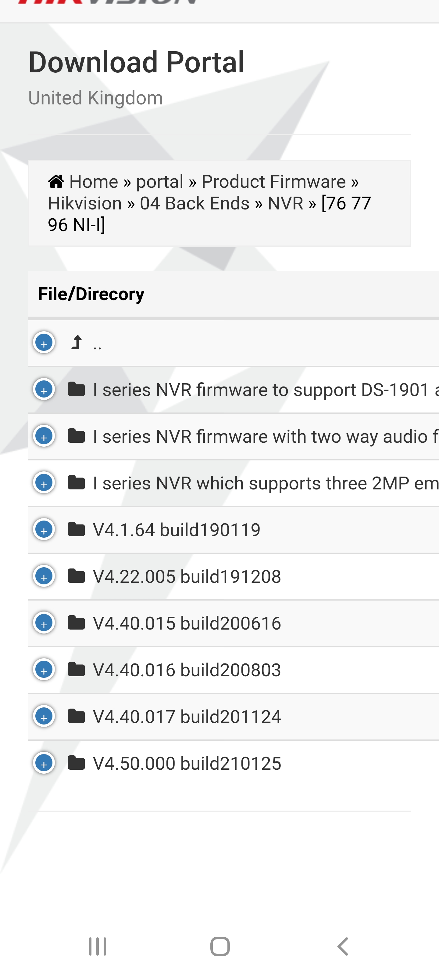

There are currently 7 upgrades for my nvr. Do I need to do them all separately?
I did my g2 cameras with the newest one and they were fine.
Hi @Vauxfan
As you are already running a v4 firmware you should be fine to update straight to the latest firmware, but if you want to be cautious you can update to v4.50.000 first before updating to the latest v4.51 firmware.

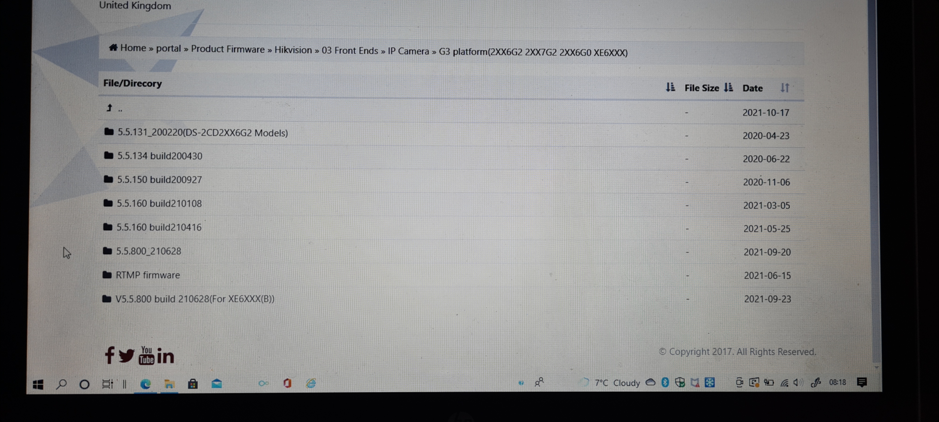

Mine is updated to 160 101108. What do I update to? Just the builds or all of the upgrades showing below my update.
Can this be done from the latest or should I do each one?
Hi @Vauxfan
As you are only 1 or 2 versions behind the latest you will be fine to go straight to the latest v5.5.800_210628 (not the very last version on the list as that is actually a very specific version for one unique camera model)

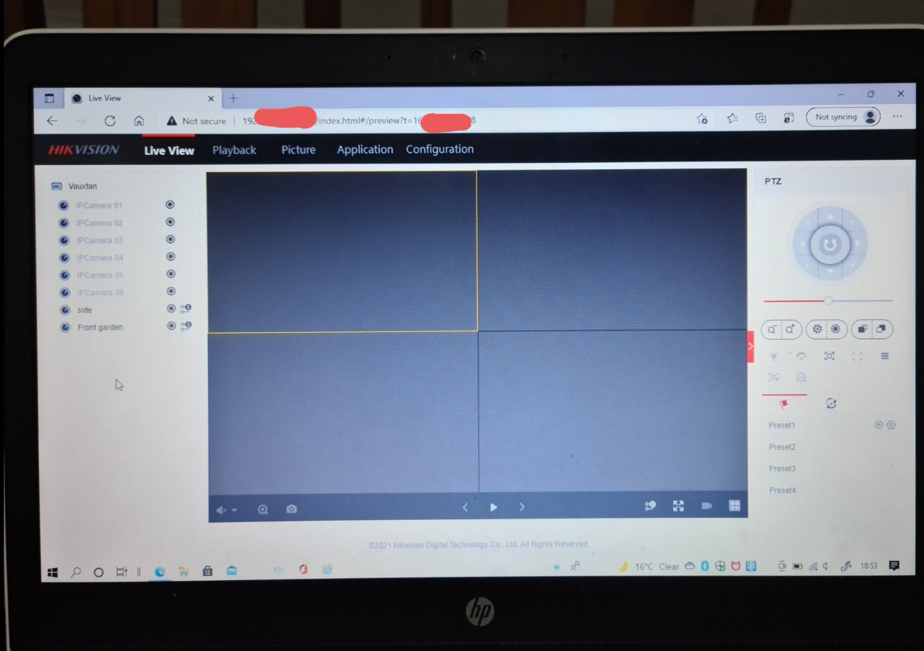

All updated. Nvr through laptop has extra features. Only issue is no picture. I only see live views through the cameras on the laptop. No the nvr on the laptop.
Tried through Google, tried through Internet explorer. Tried through Edge.
It say its encrypted on live view.
Hi @Vauxfan
This would suggest you had an encryption key set for the NVR, If you log in to the NVR using Internet Explorer you should see the box to enter the Encryption key on the Local menu.
Usually, you only have to enter the encryption key the first time after you set it but it seems updating the firmware has locked the encryption and you will need to enter the key again, if you can't remember the key you set my recommendation would be to try entering the NVR password as most use the same for both.
I can't see it anywhere.
Hi @Vauxfan
I don't understand what you mean by "I can't see it anywhere", do you mean after entering the encryption key you still can't see live images or do you mean you can't see the box to enter the encryption key?
