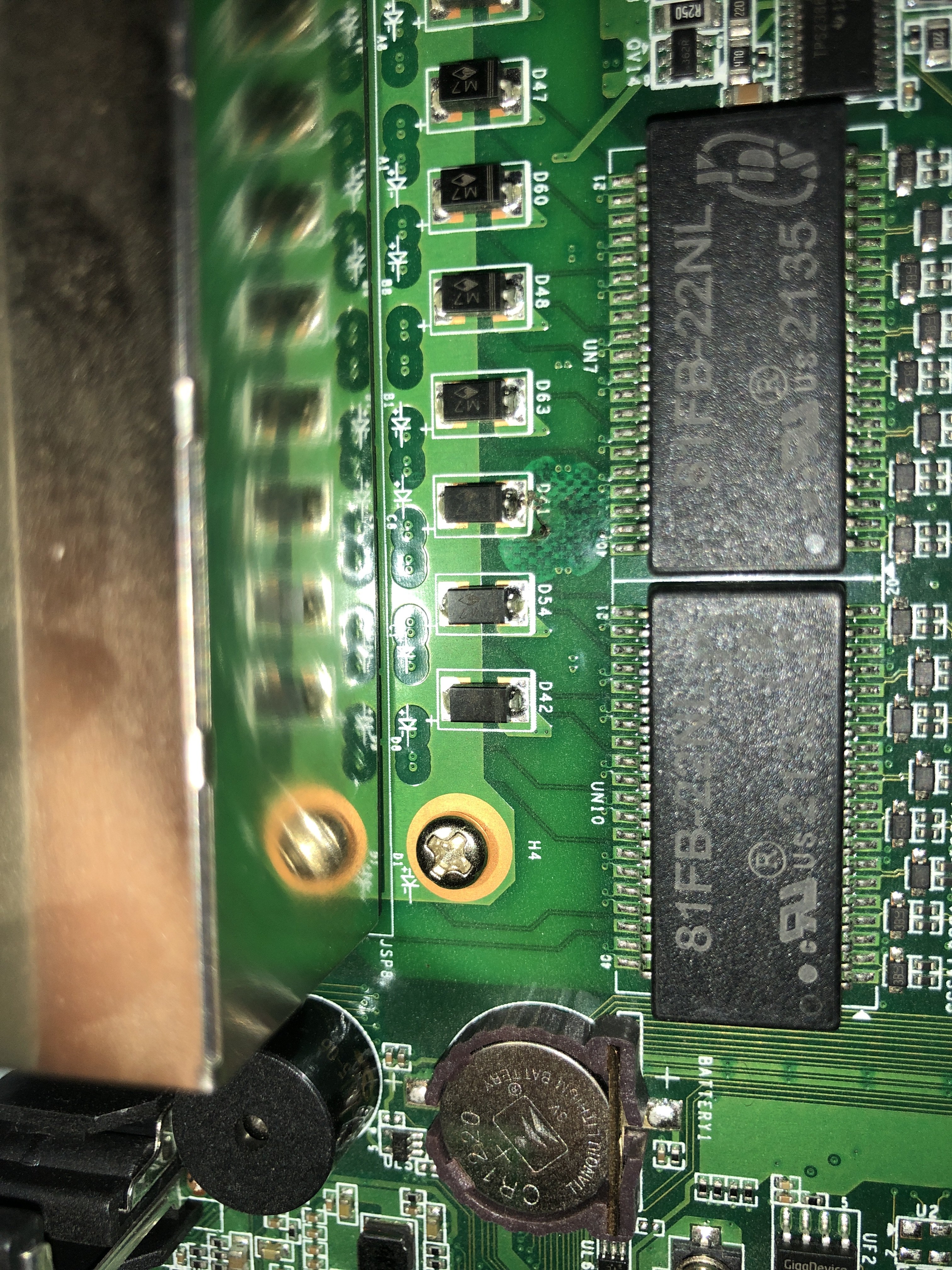

4/ NVR damaged - inspection revealed some little black bit on card marked D41

Managed to get photo attached. Please note damage on D41 and discolouration of board around area.
