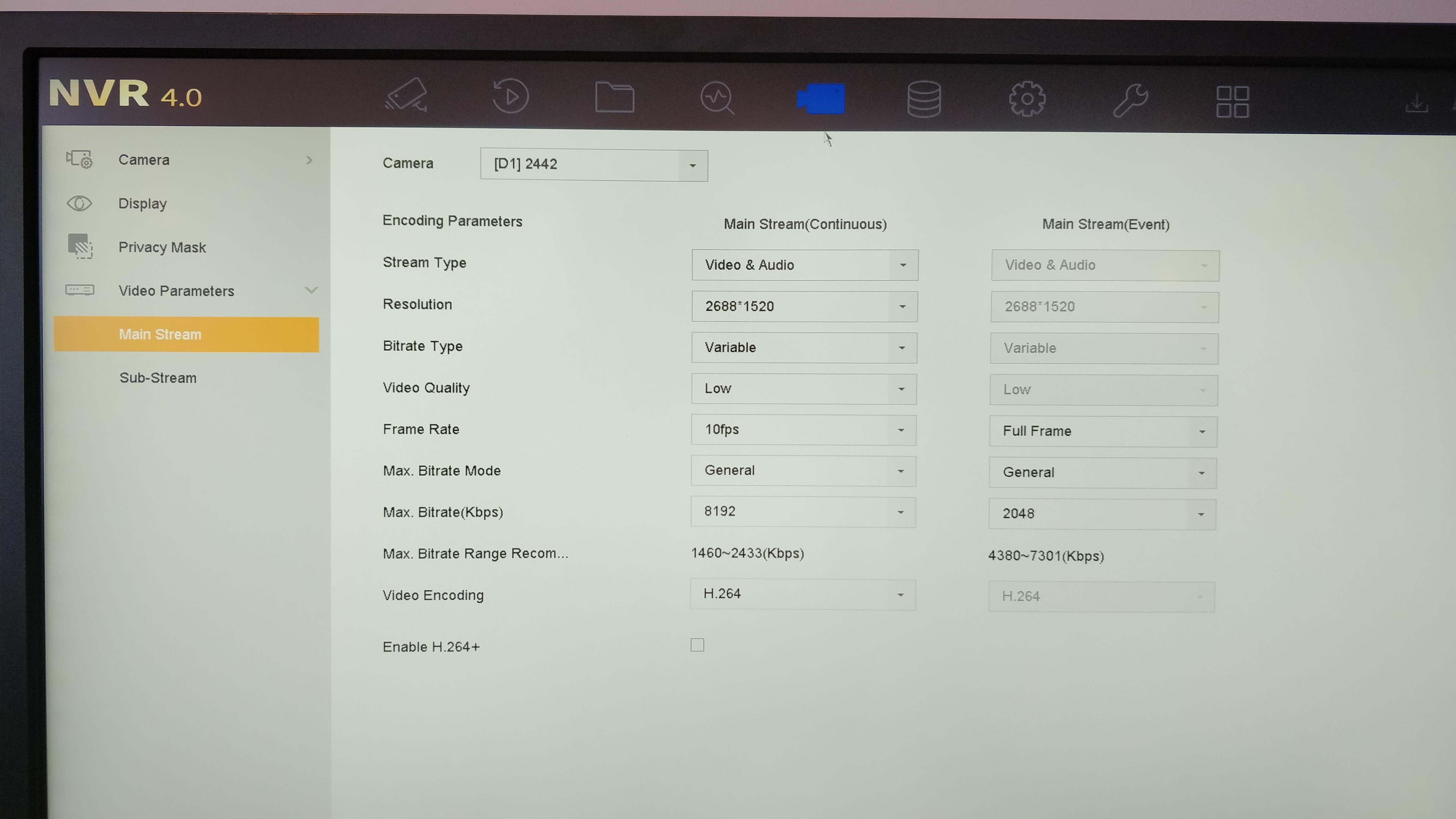

Some menus have moved in the new v4.0 GUI but you should still be able to access the video settings by going to Camera > Video Parameters and there you can adjust the video settings of both the main and substream for all your cameras.

That's very strange, we have had no other reports from customers using any I-series NVR of problems with the 4.0 GUI, Below is a photo of what you should see in the 'Camera' menu.

The only thing I can think that may have caused the problem is if initially updated in one jump from v3.3.7 all the way to v4.21.008, that is a jump of 28 firmware versions. We usually say that jumping several firmware versions won't cause a problem, but when we say that we mean jumping 2-3 versions. If you jump too many versions at once you can miss out key updates and this can cause glitches as you saw with the 4.0 GUI.
We would recommend to you first update to an earlier v4 firmware (v4.1.10) and then update to the latest v4.21.008 version from that early v4 firmware. You can find all the firmware files at the Hikvision Download Portal
