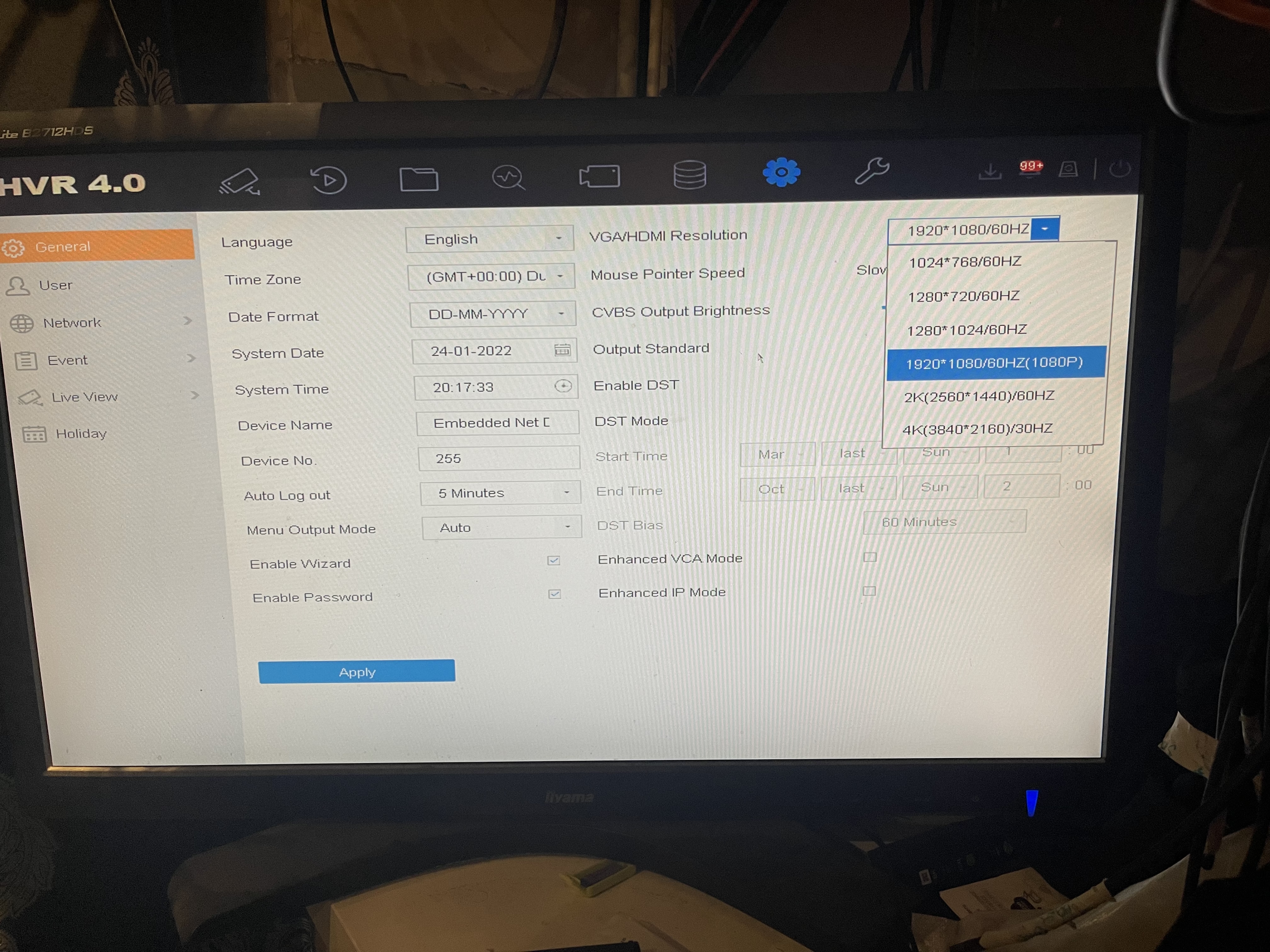

Do you have a monitor close to the NVR that you can use to access the DVR menus with a mouse? Can send a photo of the Configuration > General Menu?

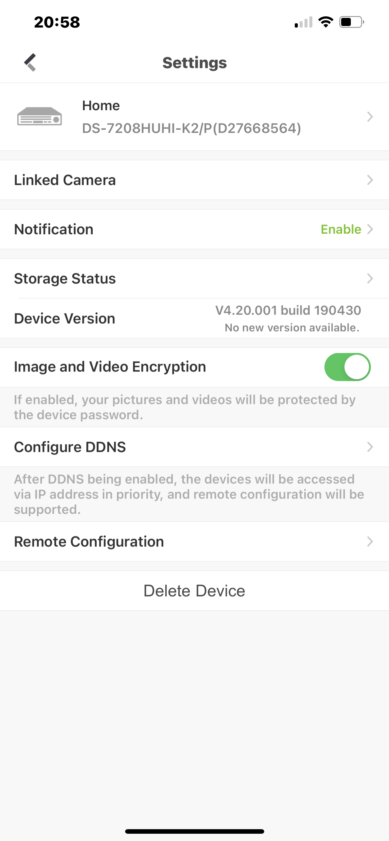

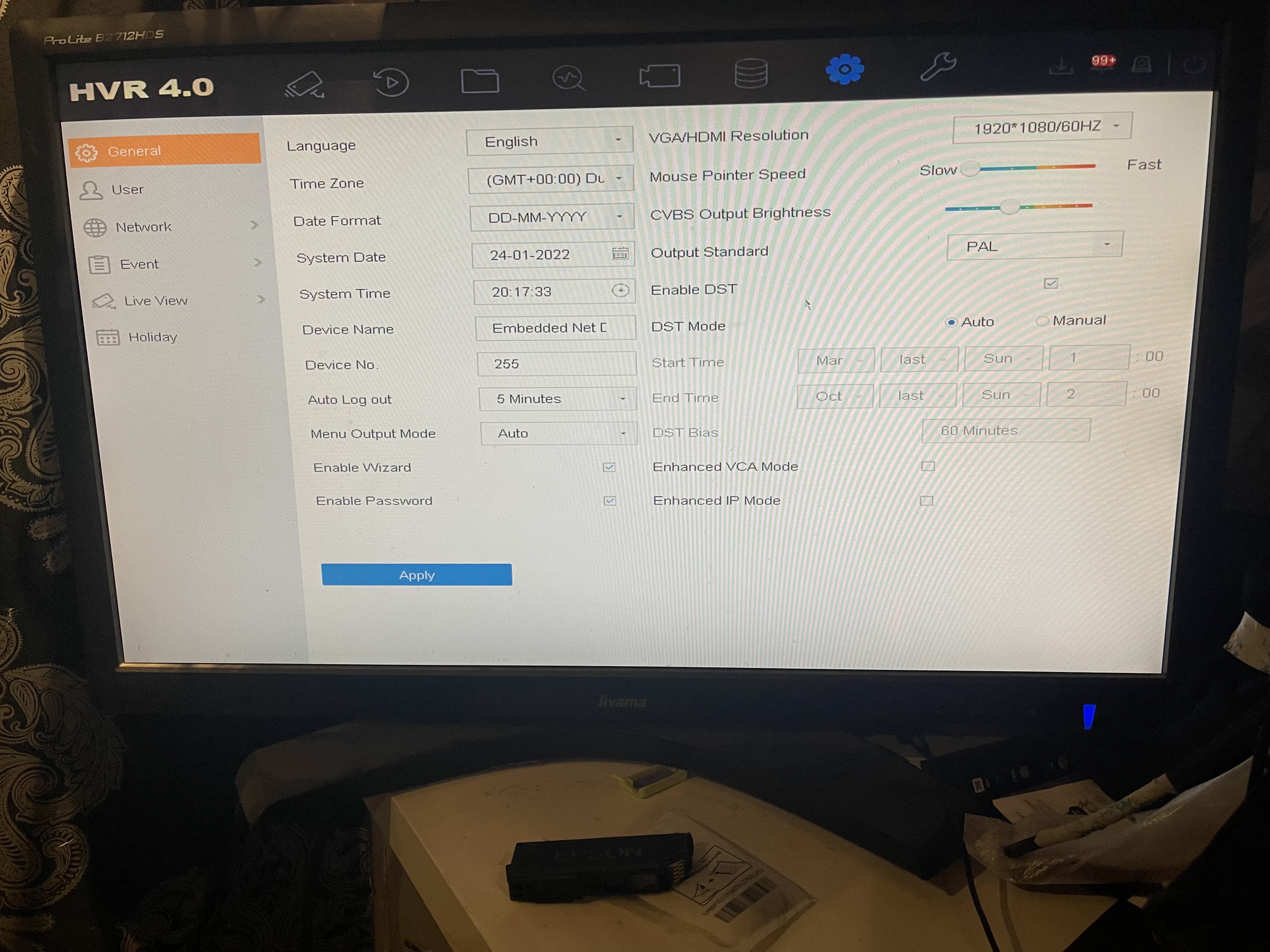

Hi Dan thanks for your fast response, I have attached a couple of photos for you, let me know if you need more, so hope I’m explaining myself clearly, if I change resolution to 4k then I can only see video on my 4k monitor in hall and on my local 4k tv via hdmi cables, but the technomate via aerial booster and local monitor shows no video as they are only HD monitors and tv’s.

Hi @Leeuk
Thanks for the photos, they confirm what I thought. We have little experience with analog DVRs but your model seems to operate the same as the older K-series NVRs in that they only have one resolution option for both the HDMI & VGA output, so there will be no way on your current DVR to have different resolution outputs for both HDMI & VGA.
We looked at a newer I-series NVR we have here and that does support separate resolution options for the HDMI & VGA output, but as I say we don't have any experience with DVRs so we wouldn't be able to recommend what the equivalent DVR model would be that supports this feature.
