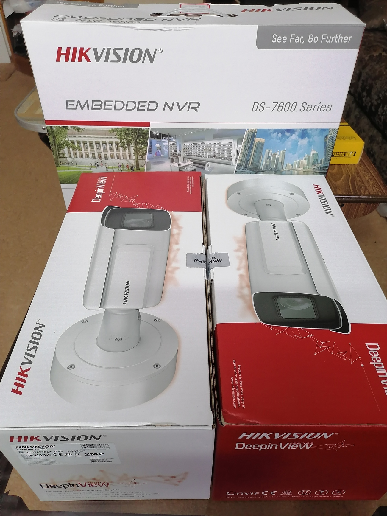

Hello Mr. Dan, Hope you are doing well and enjoying good health.
at last I received the cameras with nvr you recommended 7608ni i2.
