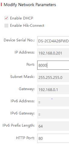

Hello guy can you pls help me enable hik connect on DS-2CD4A26FWD-IZS/P
firmware version: V5.4.5 build 171115
on SDAP tool hik-connect is grey out
Thank you

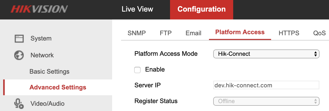

You need login to the camera with a browser and go to the platform access page shown below to enable Hik-connect P2P connection. You then also need to create an account at the Hik-connect online portal and add the device to this portal, before finally downloading the app and login in with the same credentials as the account for the online portal.
If you have done it the other way round (e.g. set up the app already but not accessed the portal) then you can use the account details you set up to login to the app to log in to the online portal.
