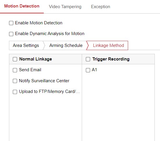

Hi All,
Just regarding the DS-2CD2387G2-LU Colorvu firmware
The camera came with firmware V5.5.801 Build 210727.
I am wanting to trigger the Led lights on motion detection, however in linkage this option doesn’t show up.
Updated to the latest firmware V5.7.1 build 211009, but once again it doesn't show.
Am I missing something or have hikvision removed Led linkage altogether.
Thought I would try and downgrade the firmware , however is says: The type of upgrade file mismatches ??
Would appreciate any feedback getting the Led lights to work or what firmware downgrade would reinstate the Led lights to trigger on motion detection.

That function has been removed by Hikvision. It's rumoured that it will be reinstated in a later firmware update but no one knows exactly when that will be.

Today I downloaded the latest Version 5.72 for the DS-2CD2387G2-LU and the LED Triggering has returned once you log directly into the camera.
In regard to it only allowing one function at any one time, if you set say the line crossing to trigger the led. you are unable to have the LED lights to come on during night time and vice versa.
However, this isn’t the case, well not with the latest firmware, I set the LED to trigger with line crossing, and set the day/night switch to night only (for testing) and led at 20%
Once I activated the line crossing the LED went to full brightness for the 5 seconds which I set them for, then went back to the 20% brightness afterwards.

The new 5.7.3 doesn’t have the feature in. I assume if you update the custom version to 5.7.3, it will stop working (unless that required bit of code is left unaltered) Guinea Pig required to try that!….

Yeah the patch that’s in 5.7.2 isn’t in 5.7.3. My assumption is that it’ll be lost if you update to 5.7.3 but that’s just my best guess. I updated mine directly from 5.7.1 to 5.7.3 so never had the feature. I’m happy to downgrade one of mine to 5.7.2 and back to 5.7.3 again to check and report back.
Ok so I just tried that quickly. I downgraded from 5.7.3 to 5.7.2 and that added the "white light" feature. I then upgraded back to 5.7.3 and the feature is removed again. So if the feature is needed, you'll need to stick with 5.7.2 until such time as Hikvision include that patch within a regular firmware build.
