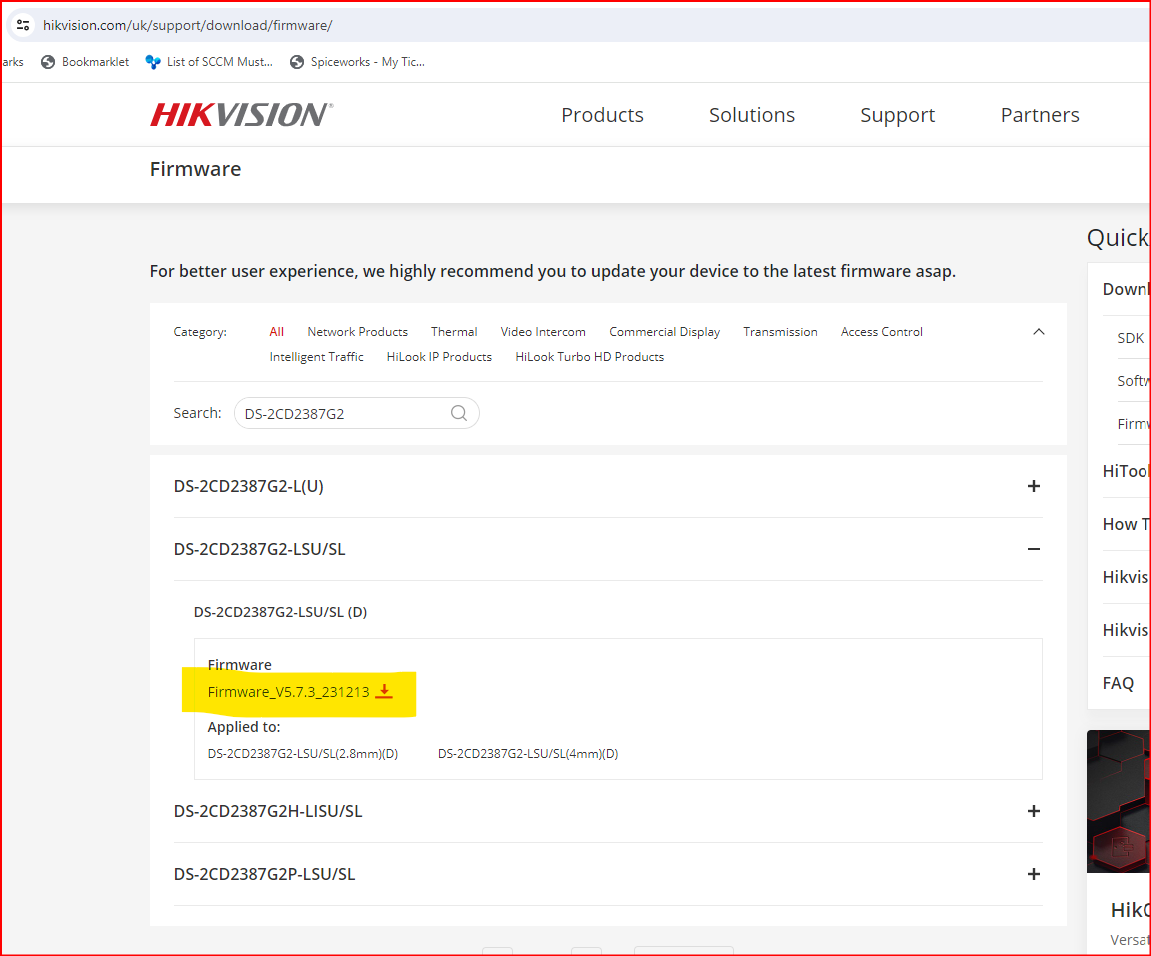

Hello all, I have a problem with the following camera DS-2CD2387G2-LSU/SL on firmware V5.7.13 build 230403
and I am struggling to find an updated version on the portal. Does anyone know if there is a higher version of firmware?
I have also checked the Hikvision product page and no firmware version is available to download.

Looks as though there is a different build number.
It's a good question @Whisky
Unfortunately, Hikvision doesn't like to make locating firmware easy :)
What complicates things is the multiple versions/generations of the same models.
In the case of the 2387G2 model above, the firmware you located on the Hikvision website is the latest firmware for the newest (D) hardware iteration of the 2387G2 camera.
The camera the thread creator has was using a firmware version (v5.7.13) that is only applicable to the previous (C) hardware generation, the latest firmware for those cameras is only available for the download portal.
What we usually recommend doing is double-checking both the firmware section on the Hik website and the UK download portal because sometimes the newest firmware is on the Hik website and sometimes it's on the download portal.
You should be able to confirm the generation of your camera model & which firmware platform (e.g. G1, G3, G5 folders in the download portal) it uses by using the attached instructions.
