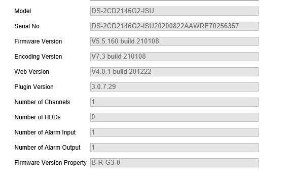

Couldn't get past "Failed" when testing the email settings until I upgraded the firmware from the 2018 it came installed to the current release:
After doing that emails worked and could send test emails.

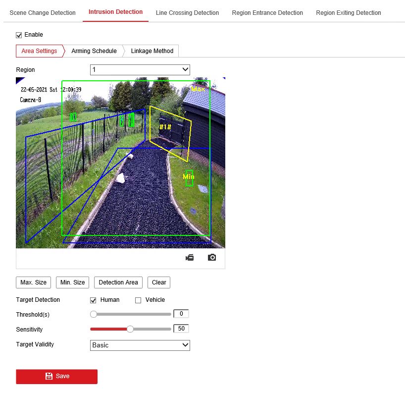

What I really want to get working is Intrusion Detection.
As far as I can this should be a matter of setting up the dectection zones, min and max target sizes, enabling it, ensuring scheduling is set and linking it to send emails.
I turned on "Rules" so I can see what it is doing in the live view and it appears to detect targets - boxes going red etc.

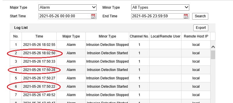

Does it log anything in the logs? NO
Does it send any emails? NO.
