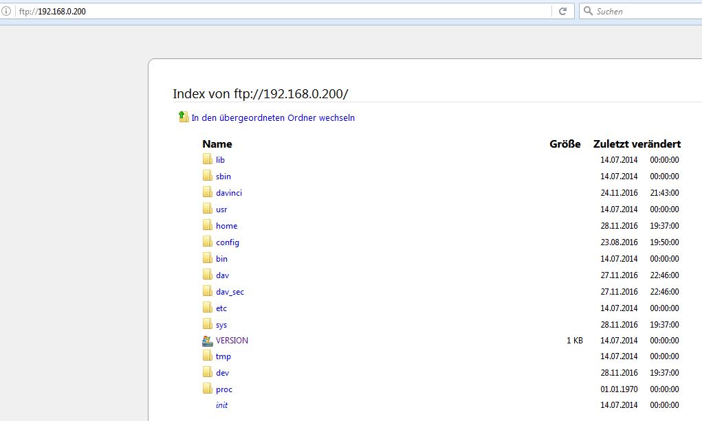

-> ip Scanner find the device, with FTP link to device-> i can see folder and files
