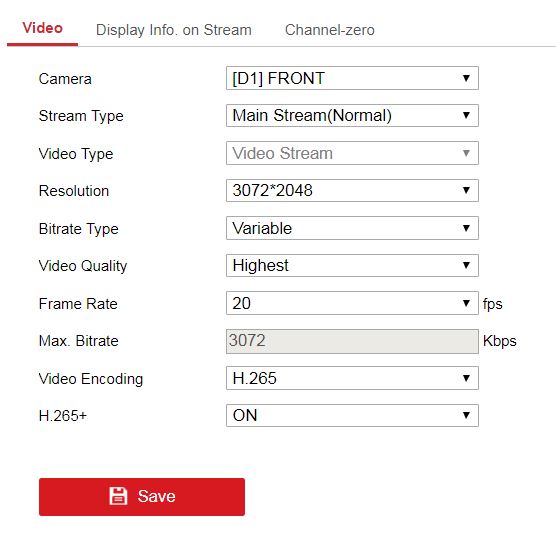

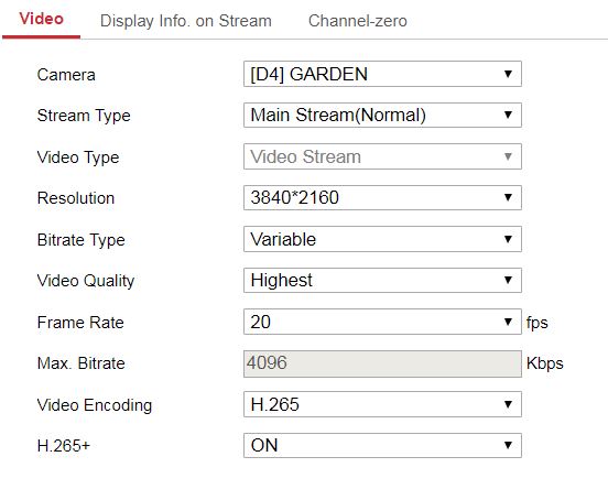

attached are the screenshot from the 8 and 5 MP cameras.

Yes they are the front scene looks out onto a road with a car passing once an hour or so, whilst the garden camera scene is very still with very little movement.
Perhaps that would explain it?
