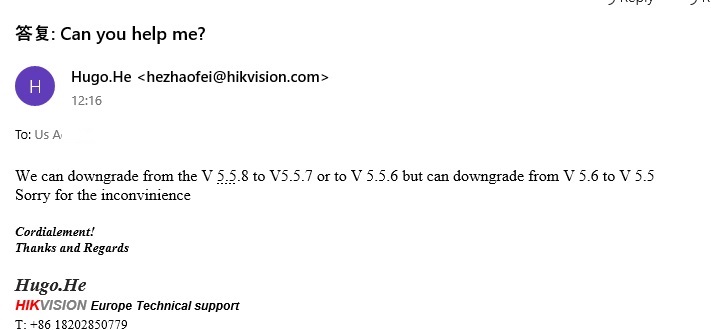

Answer from hikvision I sent mail to them

I can't say. Hopefully someone else will be able to test it. Nothing is mentioned in the release notes.
