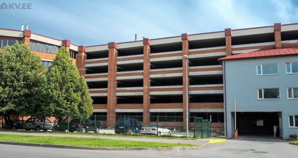

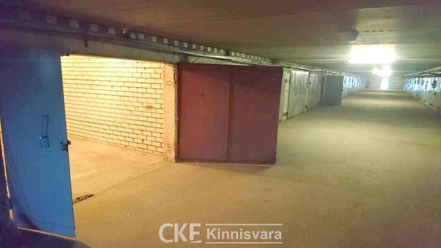

Hello all,
Could any1 recommend a camera that would be:
  • Good night vision
  • No IR to attrack attention
  • dome (so that it wouldnt be broken with the first hit by a hammer)
  • black case colors are even better
Basically, something that would be good at 10-20ft/3-6m distance, at night time. It will be installed in a garage which has no lighting at night. Wouldnt like the camera to send infrared, cause it would be like a red flag for a bull.
Thanks!

The aim is to keep a low profile as possible, so even hiding the camera from the eyesight. Cause there is a chance, that the person would try to disassemble the cam and take it away with him. The garage is in a separate building, quite some distance away from home. Thats why the strange thinking is in place.
