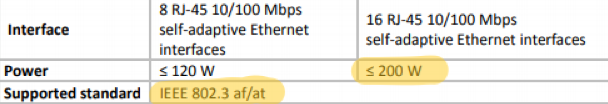

Be aware of the power budget of the NVR, the 7616-K2 model has a 200W budget and so you have to be aware if you have all or almost all the PoE ports being used that you have enough budget left to support the 2 PTZs, standard PoE cameras usually uses a max. of 15.4W but more often they use around 8-12W and the 4225IW PTZ camera you want uses a max. of 18W

You should be fine. Your NVR ports support PoE+ and has a 200W power budget.
Standard cameras will use an absolute max of 10W, and those PTZs a max of 18W, so should be well under the budget all in.
The below is from the NVRs datasheet, IEEE 802.3 af/at is just the techy term for PoE+.
