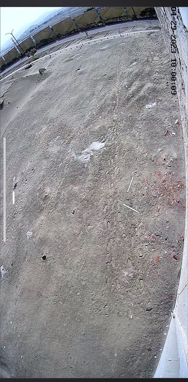

I installed a set of 6 budget Hikvision cameras + NVR HK DS 7608NI-Q2 in my house, and mostly everything is fine. Yesterday I upgraded two cameras to Acusense capable cameras and I have to admit it is a big step forward. I wanted to use one of the previous cameras to monitor an empty terrain next to my house as it can be used to enter my roof.
Two issues, first I can not turn my camera image 90 degree, I checked the different posts but no option is available, just mirror, which does not help. Anyways if motion detection would work, it is no major topic for me.
But motion detection is not working. The camera is quite high (see picture - something linke 7-8 meter off the ground, you can see my footprints to estimate the size) but still earlier even small leaves made the motion detection alarm. Is it possible that due to the detection mounting the motion detection is not working? I have no human detecion or similar activated. Any movement detection would be fine for me.

In regards to motion detection, did you change any settings between when detection was working and when it stopped? Can you share screenshots of your Motion Detection settings?
Hi, I checked the guide and no option gets avaliable, I believe it is because of the budget camera.
Will probably try with another camera and see if that helps. Will report back. Motion settings are same as before. My NVR doesnt have the "VCA resource" menu and honestly without detecion it would not be helpful.
