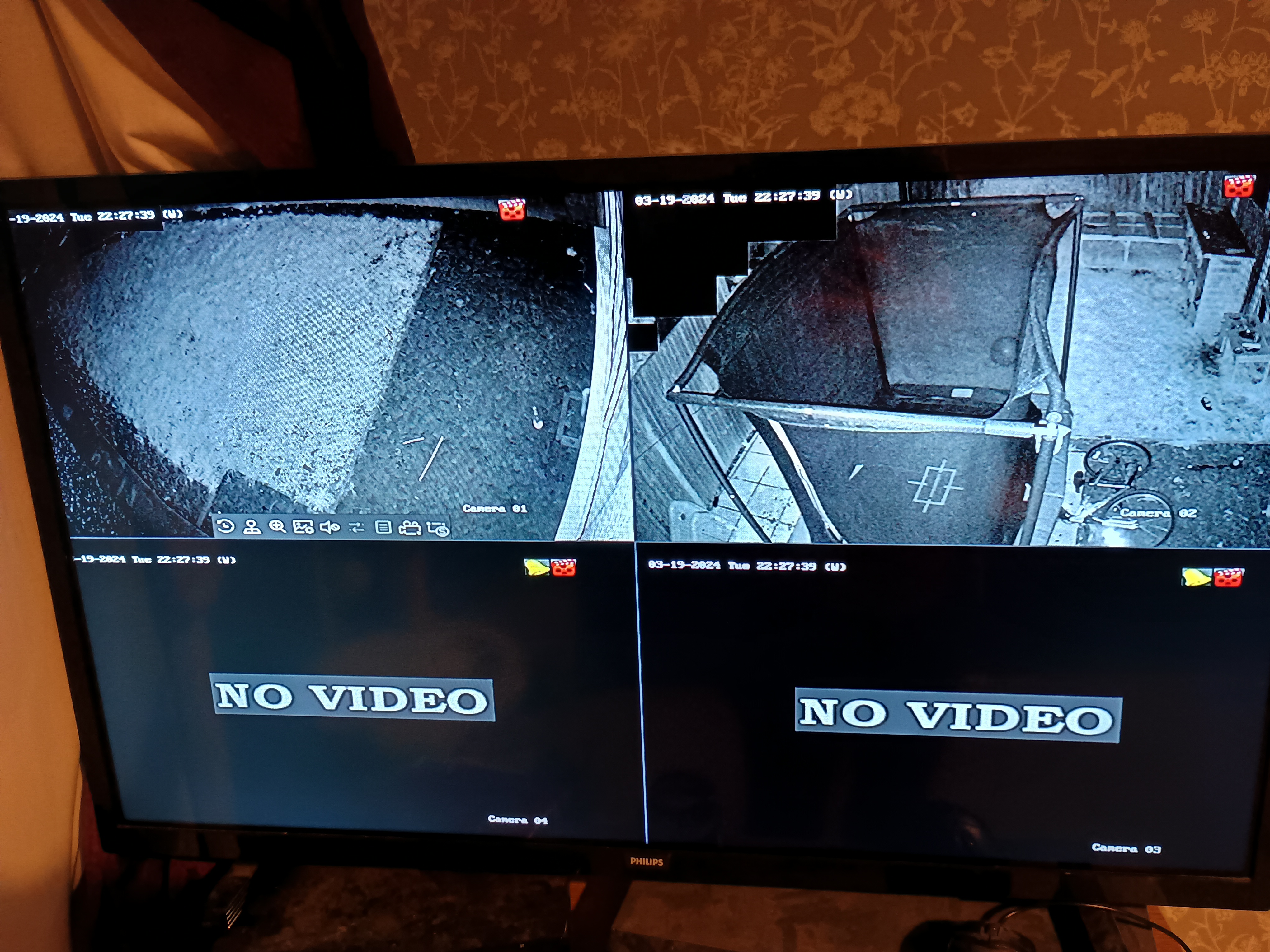

I have got a new phone. For some reason the hik connect app didn't transfer from my old phone so I had to download it again.
I put in my phone number and password like it asked.
However I can't access the cameras on my phone.
It says enter the device verification code to decrypt?
Can anyone help please?
This is my camera screen
I don't actually know where to go from here
I mean that's the screen on my Tele
I don't know where to even go from there

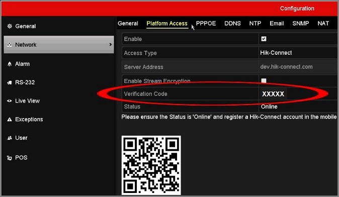

To find the verification code from your screen above, you need to log in, then go to Main Menu > Configuration > Network > Platform access.
There you will find your device verification code.

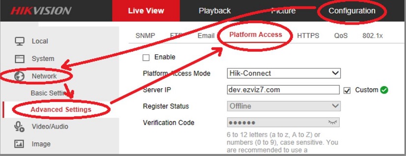

To find the verification code via a browser, you need to log into your NVR then go to Configuration > Network > Platform Access.
There you will find your device verification code. (Sometimes referred to as 'Stream Encryption/Encryption Key')
