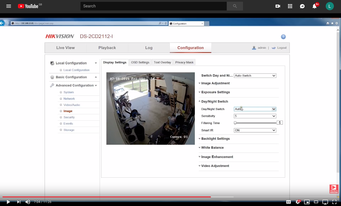

I want to be able to turn off the IR on this camera but still have the camera go to mono at night. Currently it remains full colour 24 hours per day with no IR. Here is a video I found on YouTube that explains exactly what I want to achieve.
If you go to 6:30 you will see the menu that I’d like to get to. When I try to go there I can only see Brightness Contrast Saturation Hue. If you stop the video at '7:04 exactly' you will see the sub menu (Day/Night Switch) that will give me what I want - I can't see it!

Hi @LenJones
If the camera is directly connected to your NVR you will need to enable Virtual Host to access the individual settings of each camera and change those IR/Day & night settings.
Hi Dan
Thank you so much for this. I've got it working up to the point where it asks me for the user name and password but it will not accept my normal log on details. Do you know what I'm missing please?
Hi Dan
Found it! For an unknown reason the camera password was set to 12345. Real high security . Anyway, I'm sorted and have made it work as I want. I'm over the moon! Thank you again
