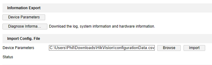

I see that under the camera's config --> maintenance page, under the heading "information export", there is a click box for "device parameters." That seems to generate an Excel spreadsheet file. Where would I go to load that file up to the new cameras? Further down that same page is a heading called "Import config file" and a click box to browse for device parameters, but when experimenting with that function it does not like the Excel file created and says something like "invalid file." Any help is appreciated.

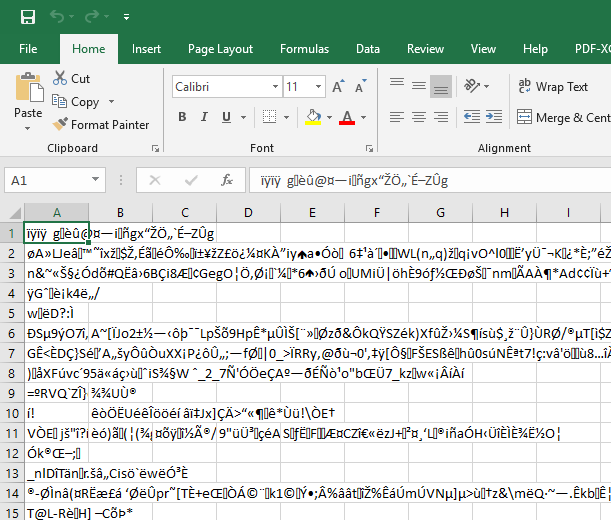

I am not given the option to change the extension to .csv before saving it. It saves in .xls format no matter what. And as before, there are headings and no information in the document. See pics below. This is if I save the IP Camera parameters from the NVR config-->system-->maintenance page. If I try to save parameters from an actual camera web interface, it saves a document called "configuration data" with no file extension and nothing I have will open it. (No idea why the language is indicated as Chinese - these are legit products from an authorized US dealer).
Save from the camera's web interface.
Type .csv at the end of the file name before saving.
The demo camera here that I used saved as Chinese too.
When viewed with MS Excel it appears as gobbledegook/garbage.
