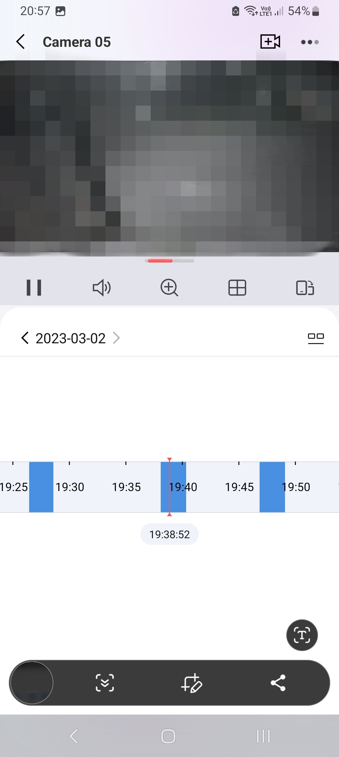

I have a HiLook DVR-116Q-K1 and recently enabled 24/7 continuous recording on Schedule Settings. However instead of a continuous solid blue stripe on time line, the cameras are still only recording based on motion detection events. Literally, the only thing that changed was the colour of vertical lines from red to blue.
I enabled continuous recording because the event-based one was completely unreliable. It commonly skips crucial moments, stops recording even though there's still clear visible motion and sometimes the cameras records a perfectly still scene. Essentially, the cameras record when they want so and are near useless.
What am I missing here? Is there any other option to ensure recording will be actually continuous? I enabled this feature on both web interface and iVMS-4200 in order to be sure the change would be applied, but still nothing. HDD is healthy and I can access the video files just fine, it seems the DVR algorithm/software that is completely useless.

Sure Dan, but what settings specifically shall I share? I don't know if there's another relevant setting besides Record Schedule, but here's an additional screenshot which shows the HDD status:

Thanks @ksio89
Have you selected each camera from the dropdown at the top of the record schedule and set each camera to continuous?
If you go to Storage > Advanced Settings > Other do you have 'Enable Overwriting' ticked?

Yes, all cameras schedules are set as depicted in the screenshot, and overwriting is also enabled. I don't see any other setting which could make continuous recording work, I'm so disappointed by this HiLook DVR.

yeah very strange, from doing some searching online this HiLook DVR model does not appear on the UK or Global Hikvision and only seems available from specific regional suppliers, this might suggest that this model is a customised model using custom firmware and there might be a glitch with that firmware/software.
If possible, maybe try contacting your original supplier to see if they can source any newer firmware for this model.

I guess this HiLook low-end line of DVRs is only sold in developing countries like mine. The hardware is pretty good, but it's undermined by the buggy software/firmware, and sadly there are no updates available. Maybe I'll resell it and buy a higher end model, I don't know, I'll avoid HiLook products from now on.
