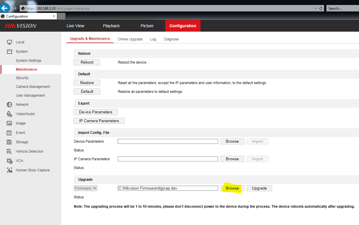

RE: Firmware updating.
Clicking the update button has never worked for me.
Try the following:
Download the firmware from the link Phil provided above.
Extract the ZIP file to a folder on your PC. The firmware file will be called digicap.dav

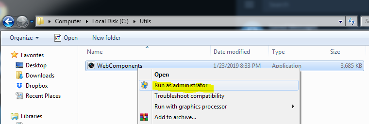

Use Internet Explorer 11 to access the NVR's web GUI, when prompted to install WebComponents.exe agree to download it.
Close all web browsers and run WebComponents.exe as Administrator (right click the file for the option)
Open IE 11 again navigate back to the NVR's IP address.
When IE prompts you to allow WebComponents permission to run click 'Allow Always'
Navigate to Configuration>System>Maintenance and browse to the location of the firmware update file.
Then click Upgrade.
Keep us posted.

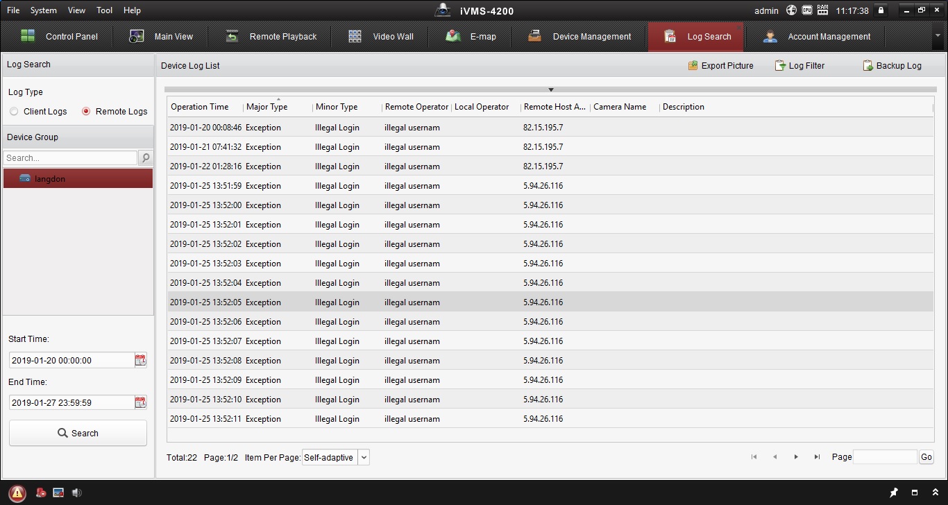

I get random attacks on my NVR (see picture) if I were you I would turn off email notification or it will drive you nuts.

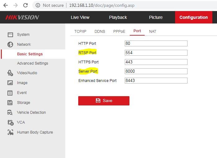

Changing your default ports might help. You can always revert.
Another lead: (Can only find this setting on my cameras).
