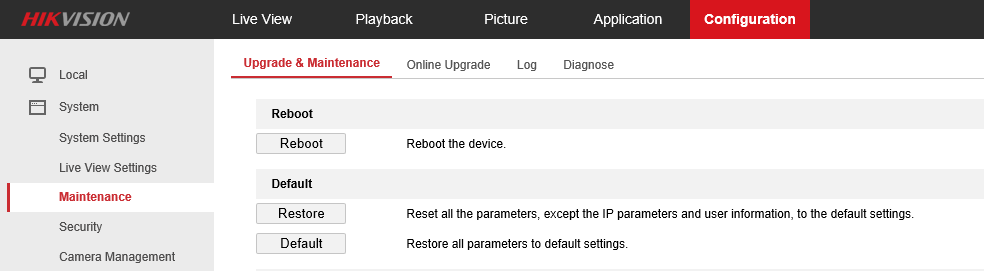

You can reboot the NVR through the browser without having to open the cabinet. Go to:
Config > System > Maintenance > Upgrade & Maintenance > Reboot
I know, but the event is 24/7 and it will not record while rebooting. No biggie, don't really care as I can do everything via camera interface.
