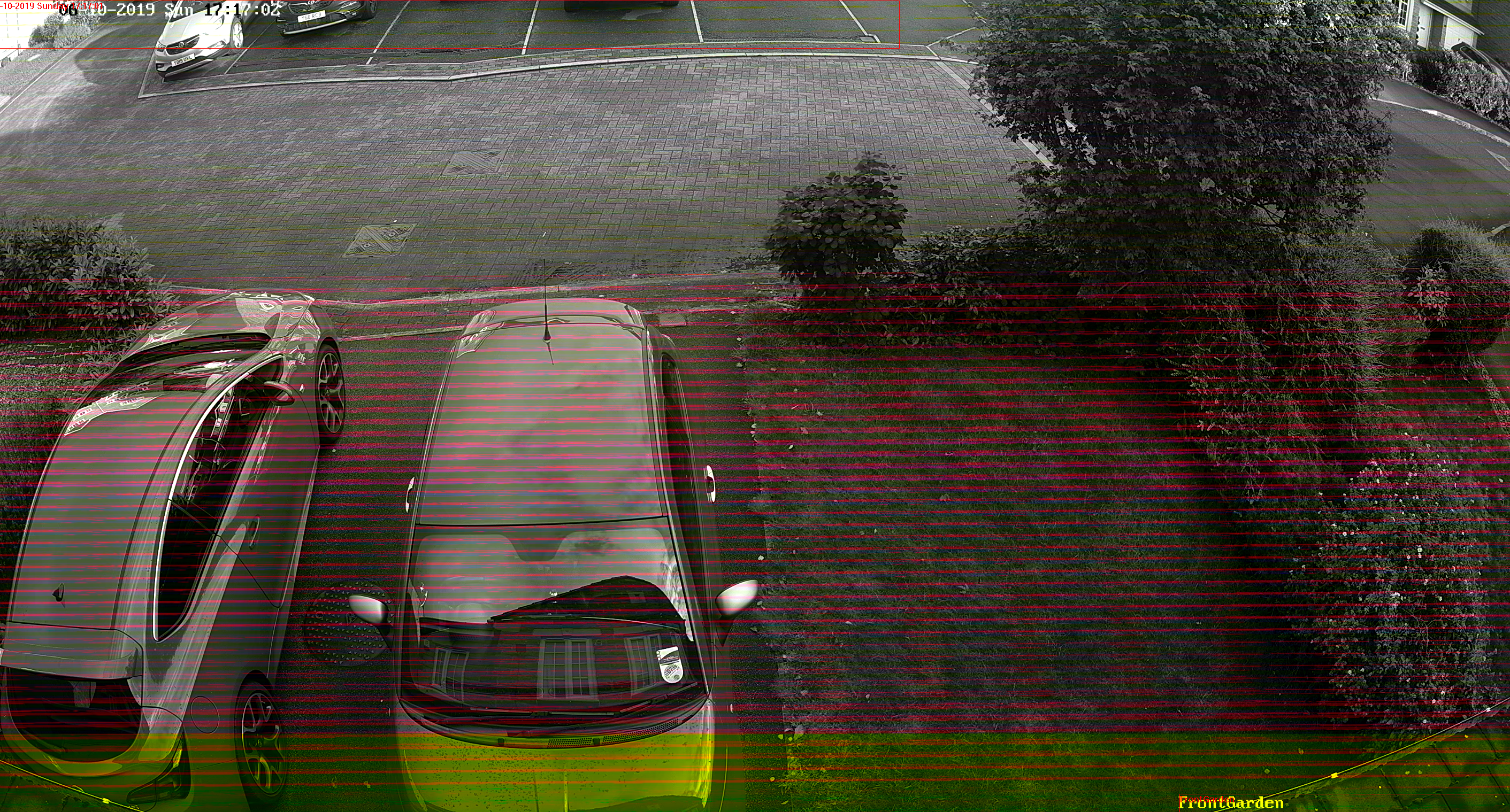

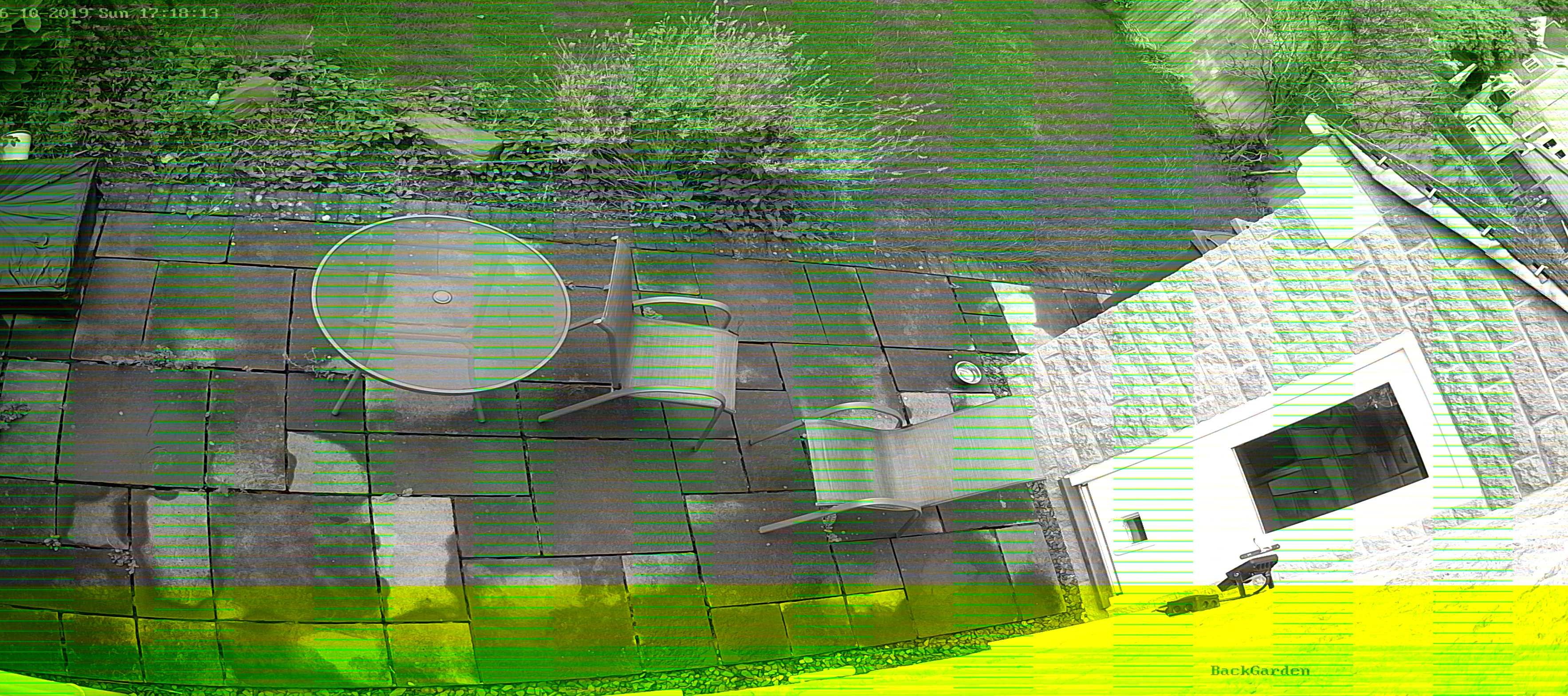

Hi Guys
I use my PC to view my 2 cameras, and since getting an AMD RX5700XT graphics card using Internet Explorer with the webcomponents plugin the colours are not displaying correctly, especialy during the day. I never had this problem with my NVIDIA graphics card, and if I log on using my laptop (intel gfx) it works fine, so it is not a problem with the camera. I can also view it fine using my Synology NAS software, on the PC with the AMD card.
Please see the attached files to see what I mean.
Has anyone else experienced this? How do I fix it?

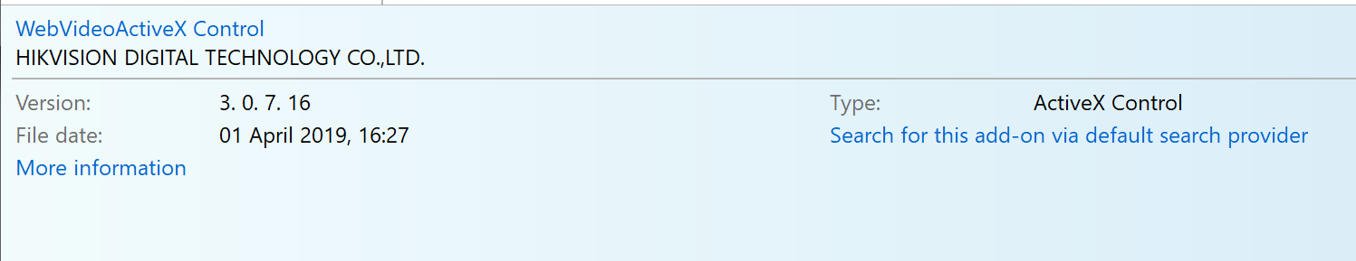

If you upgrade to the latest camera firmware you should be prompted to download a new version of WebComponents.exe, download it then close all browsers and run the file as admin to update it.

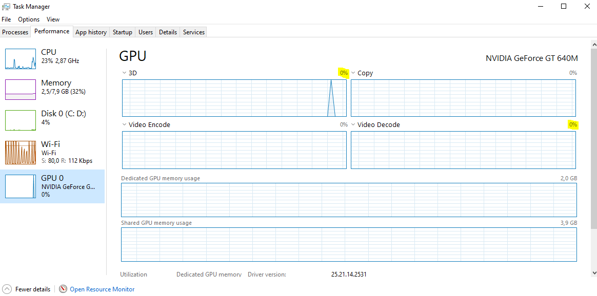

Does the PC have a AMD or Intel CPU? It might be worth checking the decoding isn't happening on the CPU/APU by mistake. You can check that in task manger on the performance tab. If the RX5700 is not utilized perhaps the global setting has reverted to the CPU/APU.
Thanks for the post Stewart. I am running the latest drivers, and latest web components plugin (3.0.7.16) I tried turning off H254+ and H265+ on both cameras, it made no difference.
I am running a Ryzen 1700 so there is no built in APU / GFX.
